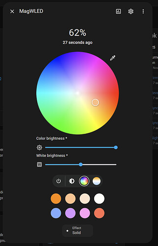

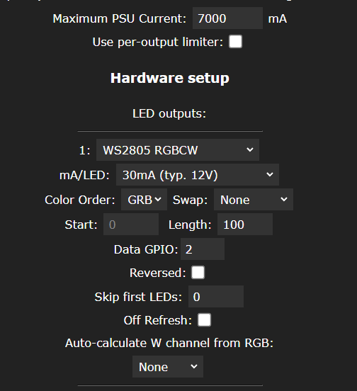

I loaded up Home Assistant and added a MagWLED-1 I got today running 0.15.0. This is my first ever time using WLED, but I think I figured it out.
Everything works with my WS2805 RGBCCT strip in WLED, but in Home Assistant, it’s funky.
The white LEDs do activate, and I see everything here:
But it’s not working right. Clicking anything on the Color screen causes it to reset back to what’s shown in my screenshot even though the actual state changed in WLED.
Here’s a rundown:
  1. On-off state syncs with in Home Assistant.
  2. Total brightness syncs with in Home Assistant.
  3. Color nor color brightness nor white brightness sync with Home Assistant.
  4. White temperature syncs with Home Assistant.

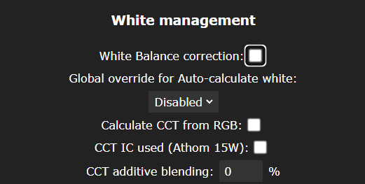

So it’s something about the Color info not being properly reported back for some reason. That or there’s something funky with my setup:
There’s also this stuff I haven’t touched at the bottom:
Anyone else able to confirm?
I saw this on some WLED docs, but I don’t think it’s accurate for 2025:
WLED devices are not supported by Home Assistant 2022.2 or later if a CCT bus is configured or White Balance Correction is enabled.
We hope to resolve this issue as soon as possible. As a temporary workaround you can enable the option Calculate CCT from RGB in LED settings.
Source: Home Automation Integration - WLED Project
If it is though, that’d explain why we’re having this issue. Even with White Balance Correction enabled, we have CCTs.
