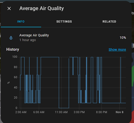

They’ve updated how to access Filter Life and Air Quality data. This is my current working configuration and card setup.

      air_quality_int:
        device_class: humidity
        unit_of_measurement: '%'
        unique_id: levoit_131s_air_purifier_air_quality_int
        friendly_name: Air Quality Interger
        value_template: >-
          {% set mapper =  {
              'excellent' : '100',
              'good' : '65',
              'fine' : '35',
              'bad' : '10' } %}
          {% set state = states('sensor.levoit_131s_air_purifier_air_quality') %}
          {{ mapper[state] if state in mapper else '0' }}

If using this chunk of code, you should probaly remove theme: material_dark_theme_custom, unless you have that theme setup. It allows for transparent cards. I am directly pasting what I have working to hopefully help others.
I added device_class: humidity, in an attempt to get history/recorder to show a graph instead of the horiontal bar of data. I ended up having to manually delete data from InfluxDB with InfluxDBStudio to get rid of non-numeric string entries for sensor.air_quality_int before I found out that unit_of_measurement: '%" is required under air_quality_int in configuration.yaml. Once I did that, and rebooted the server, graphs started to show up. Humidity device_class can probably be removed.
