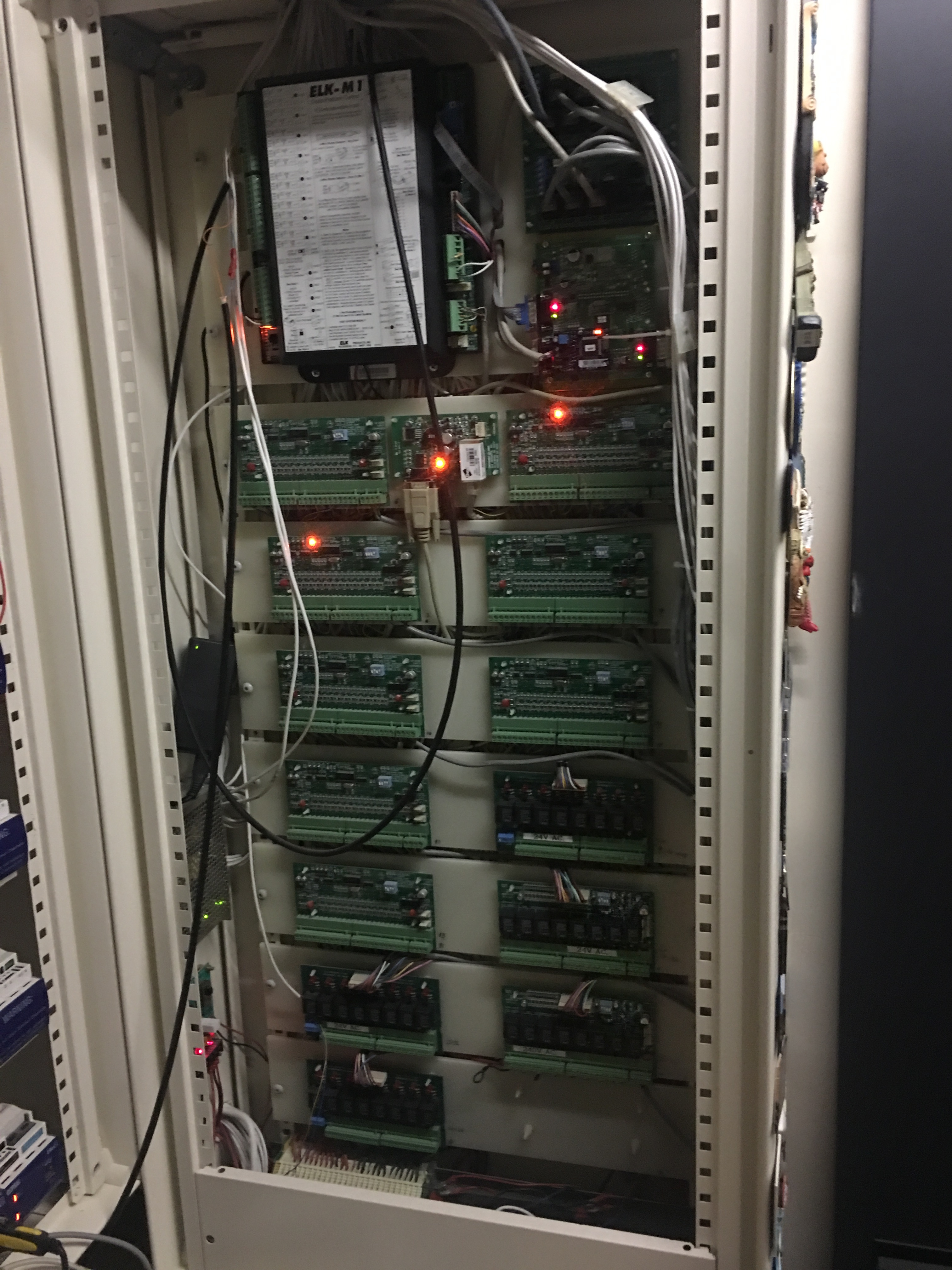

To help aid an illustration, my own system for lighting has a CBus network which includes the Gateway, Automation Controller, about 30 Switch Pads (2,4 and 6 button layout), 2 x 12 channel relay packs and 6 x 8 channel 1A dimmer packs and 2 x 4 channel 2A dimmer packs. All in this system is 100% self sufficient and can deal with power failures just like a normal system. All dimmer packs are trailing edge as that helps a lot with low current loads, and use many 18w Hallogen bulbs, all dimmer loads ramp from 0 to full (which is locked to 90%) over a minimum of 2 seconds which has resulted in most bulbs lasting over 7 years! And the 90% maximum has reduced the max 18w current draw of th bulb to about 14w with no visual brightness (lux) difference.
The automation controller serves mainly as a sceen store, and runs some routines like outside lights at dusk.
Homeassistant in this setup becomes just another smart controller which has the ability over MQTT to speak with the bus, report the state of every light, and trigger channels, scenes or automations. This allows me to bridge the smart lights with other environmental data for example motion or security.
Beside the lighting system I also run independent security panel with 180 sensors, in this case the now aging but still super flexible and utterly reliable ELK M1, which will run all these sensors for 48 hours on 2 x 12 gel batteries! As with the lighting system the ElK can also communicate with Home assistant in great detail.
ELK M1 with covers off and a test connection for a new Cartel sensor hanging loose
Clipsal CBus with covers off to illustrate the main panel, automation and gateway at bottom, fused channel ends at top
