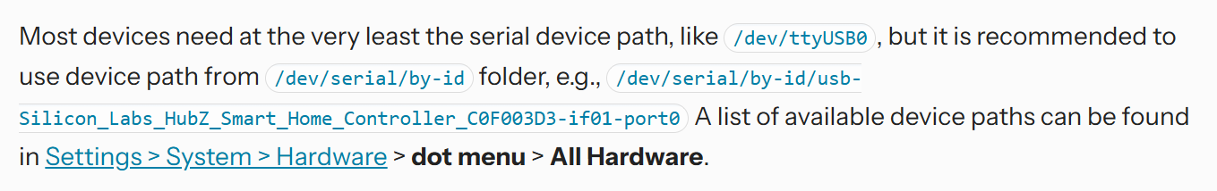

However, I strongly suspect that your underlying issue is this:
When you do move to Proxmox and set up your integrations, make sure whatever integration is using a USB device is set up to use the by-id path, since that never changes.
