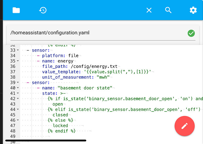

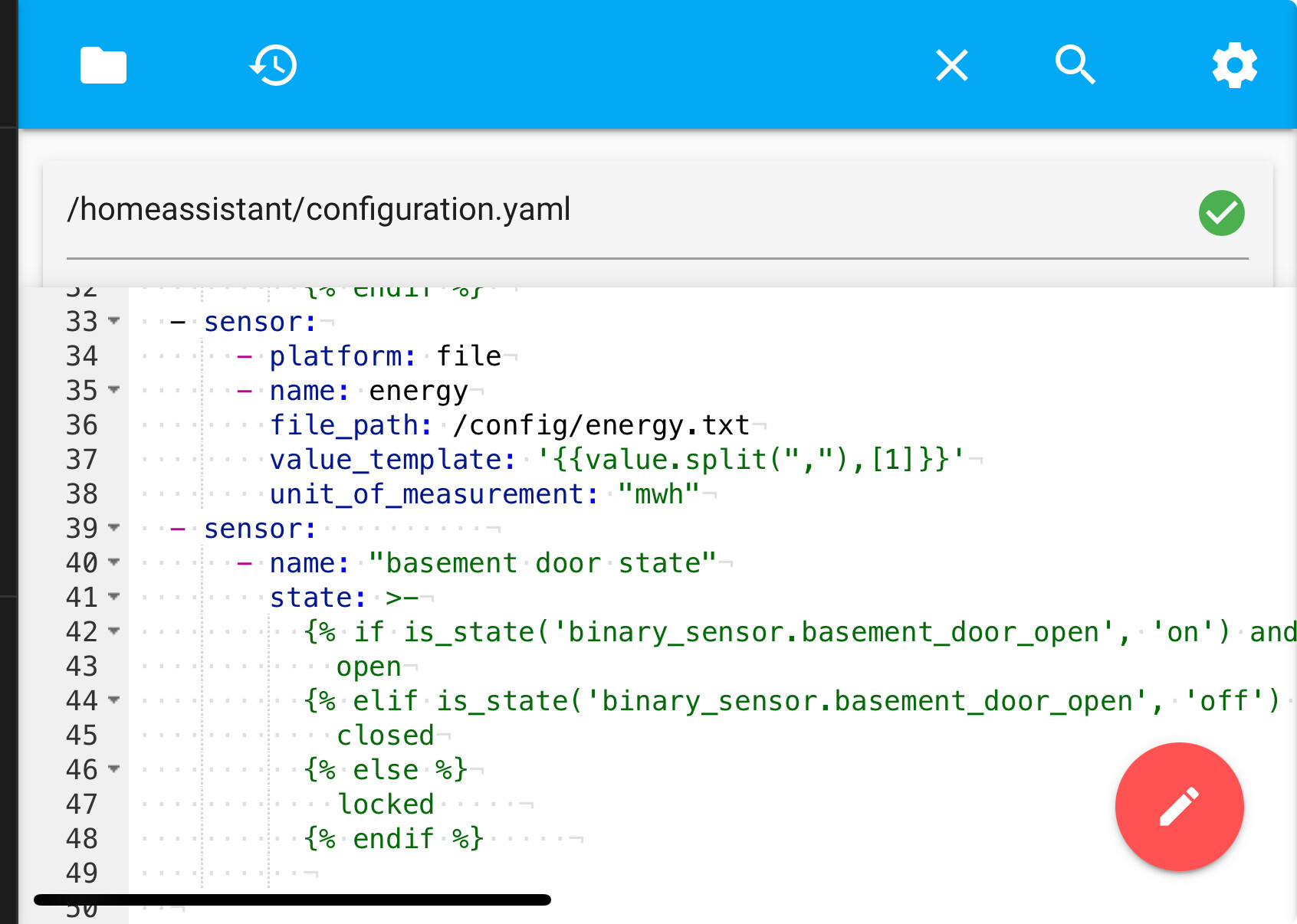

I was able to use the notify to file and store solar data to a file using automation. I followed all the recipes to get home assistant to read that file with no success and lots of frustration. I took screenshots of relevant parts of my configuration
yaml file. Any suggestion is appreciated.
Home assistant has access to the folder since I am able to add data to the file.
Please don’t post screenshots of text. People willing to help have to type them over.
Sorry about that.

No duplicate - sensor:
Forgot quote on last mhw
