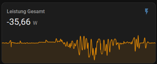

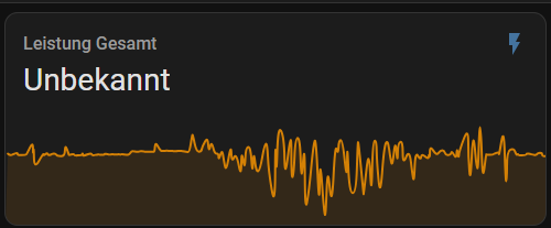

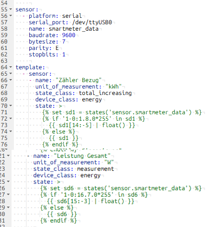

Good evening,
after update to version 2026.3.x this configuration won’t work anymore.
Strange situation: History data is fine, but the current values will be showed as “unknown”…any ideas?
Thanks in advance!
Markus
