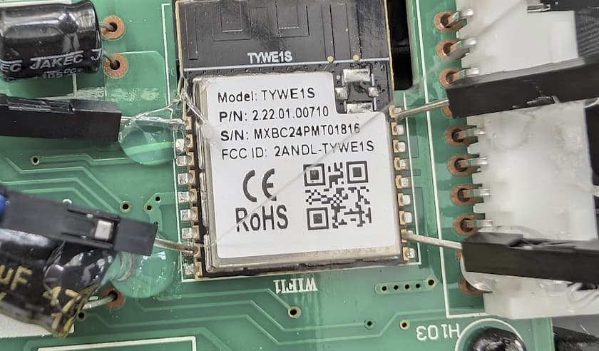

I have a Duux Whisper Flex Smart Fan (DXCF10), and I was able to flash ESP Home on it using this code;
I was able to flash like so;
but I cannot see the console messages, so I cannot troubleshoot, do I need to connect more wires to be able to read the console messages?
