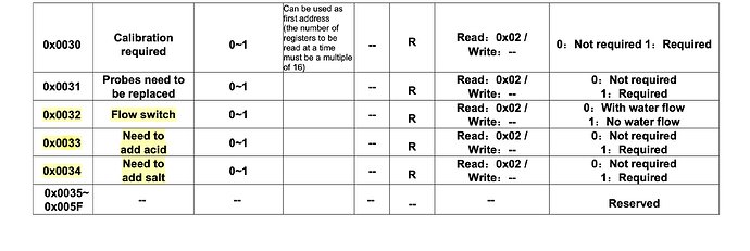

Hello everyone, I need advice about reading discrete inputs in esphome modbus.
I need to read the address 0x0032 flow switch. The manufacturer wrote back to me: To read 0×0032, we need to change the address from 0×0032 to 0×0030 and then offset 2 bits to get the status of 0×0032. The first address must be 0×0030. But still it doesn’t work for me. Other things like read: 0x03, 0x04 and write: 0x06 work without a problem.
My configuration:

- platform: modbus_controller
modbus_controller_id: mrpure
icon: "mdi:check-circle"
register_type: discrete_input
address: 0x0030
byte_offset: 2

[09:51:20][C][modbus_controller:348]: Sensor type=2 start=0x30 offset=0x2 count=3 size=1

[09:51:28][VV][modbus_controller:228]: Updating range 0x30
[09:51:28][V][modbus_controller:191]: Range : 30 Size: 3 (2) skip: 0

[09:51:28][V][modbus:210]: Modbus write: 02.02.00.30.00.03.38.37 (8)
[09:51:28][V][modbus_controller:557]: Command sent 2 0x30 3

[09:51:29][V][modbus:210]: Modbus write: 02.02.00.30.00.03.38.37 (8)
[09:51:29][V][modbus_controller:557]: Command sent 2 0x30 3
[09:51:29][V][modbus_controller:044]: Sending next modbus command to device 2 register 0x30 count 3
[09:51:29][VV][uart.arduino_esp32:180]: Flushing...
[09:51:30][V][modbus_controller:044]: Sending next modbus command to device 2 register 0x30 count 3
[09:51:30][VV][uart.arduino_esp32:180]: Flushing...
[09:51:30][V][modbus:210]: Modbus write: 02.02.00.30.00.03.38.37 (8)
[09:51:30][V][modbus_controller:557]: Command sent 2 0x30 3
[09:51:30][W][modbus_controller:027]: Modbus device=2 set offline
[09:51:30][D][modbus_controller:040]: Modbus command to device=2 register=0x30 countdown=0 no response received - removed from send queue
[09:51:30][V][modbus_controller:044]: Sending next modbus command to device 2 register 0x00 count 1
[09:51:30][V][modbus:210]: Modbus write: 02.03.00.00.00.01.84.39 (8)
