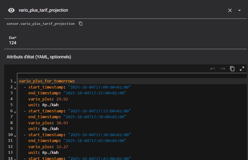

I’ve finally been able to create a working code and I am sharing it here if it can help anybody:
command_line:
  #get vario plus tariffs from now until tomorrow end of day
  #must be scheduled at around 6PM to be sure to have to whole data from tomorrow
  - sensor:
      scan_interval: 31536000
      command: >
        echo "{\"vario_plus_for_tomorrow\":" $(
        curl -s 'https://api.tariffs.groupe-e.ch/v1/tariffs/vario_plus?start_timestamp={{ (now()).strftime('%Y-%m-%dT%H:00:00%:z') }}&end_timestamp={{ (now() + timedelta(days=2)).strftime('%Y-%m-%dT00:00:00%:z') }}'
      value_template: >
        {{ value_json.vario_plus_for_tomorrow | length }}
      json_attributes:
        - vario_plus_for_tomorrow
  #get dt_plus tariffs from now until tomorrow end of day
  - sensor:
      command: >
        echo "{\"dt_plus_for_tomorrow\":" $(
        curl -s 'https://api.tariffs.groupe-e.ch/v1/tariffs/dt_plus?start_timestamp={{ (now()).strftime('%Y-%m-%dT%H:00:00%:z') }}&end_timestamp={{ (now() + timedelta(days=2)).strftime('%Y-%m-%dT00:00:00%:z') }}'
      value_template: >
        {{ value_json.dt_plus_for_tomorrow | length }}
      json_attributes:
        - dt_plus_for_tomorrow
#extract the vario plus energy cost from attributes of vario_plus_tarif_projection
sensor:
  - platform: template
    sensors:
      vario_plus_tarif_live:
        friendly_name: "Vario Plus live"
        unit_of_measurement: "Rp./kWh"
        value_template: >
          {% set dt = now() %}
          {% set minutes = (dt.minute + dt.second/60 + dt.microsecond/1000000) / 15 %}
          {% set rounded = (minutes | int) * 15 %}
          {% set rounded_time = dt.replace(minute=0, second=0, microsecond=0) + timedelta(minutes=rounded) %}
          {% for item in state_attr('sensor.vario_plus_tarif_projection', 'vario_plus_for_tomorrow') %}
            {% if item.start_timestamp == rounded_time.strftime('%Y-%m-%dT%H:%M:%S+01:00') %}
              {{ item.vario_plus }}
            {% endif %}
          {% endfor %}
  #extract the dt plus energy cost from attributes of dt_plus_tarif_projection
    sensors:
      dt_plus_tarif_live:
        friendly_name: "dt Plus live"
        value_template: >
          {% for item in state_attr('sensor.dt_plus_tarif_projection', 'dt_plus_for_tomorrow') %}
              {{ item.dt_plus }}
            {% endif %}
          {% endfor %}

Sorry for reviving such an old post.
@jayjay1 I don’t know if you’re still active on the forum, I’d like to have your advice. I found this topic while googleing, as I also try to plot a graph with the Groupe E vario energy tarifs for the next day.
I successfuly implemented the command_line part to get the values, and I got a nice array as a result, but I can’t plot a graph. I tried your code, tried to get some help from ChatGPT, but none of the solutions that it propose don’t work either. GPT told me that it could me an issue with the apex version, is that plausible? Got anyone an idea how to plot “start_timestamp” and “vario_plus” from that JSON?
Here’s the array:
And here’s the apex code form jayjay1:
type: custom:apexcharts-card
apex_config:
  legend:
    show: false
graph_span: 30h
span:
  start: minute
header:
  show: true
  title: Energy cost projection
  show_states: false
  colorize_states: true
series:
  - entity: sensor.vario_plus_tarif_projection
    extend_to: now
    data_generator: |
      return entity.attributes.vario_plus_for_tomorrow.map((item) => {
        return [new Date(item.start_timestamp).getTime(), item.vario_plus];
Unfortunately I’m still a newbie, and the learning curve is quite steep :wink:
Gabriel
EDIT: problem solved. A conflict with another card prevented apexcharts to work.
