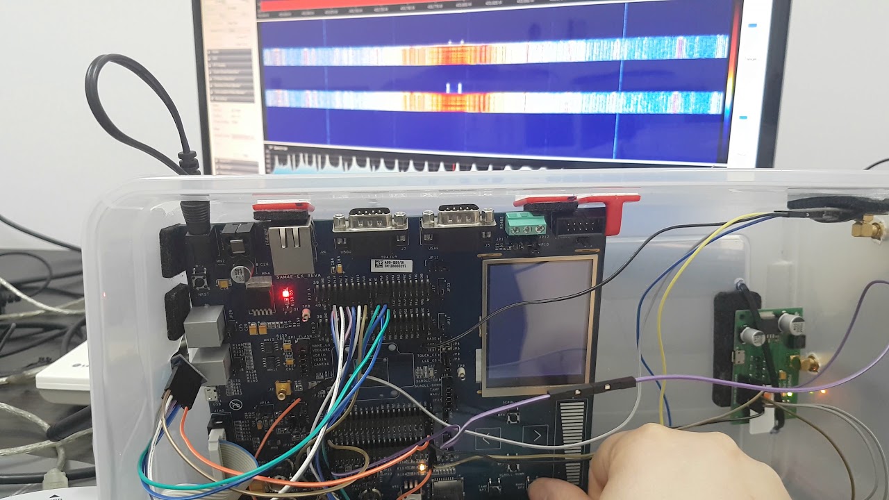

However, thanks for the video link. There seems to be little context of what they are doing or any further details. I did some quick due-diligence checks and there are no published vulnerabilities associated with the Itron Cyble and the video content seems unrelated to the read counter check.

I do appreciate the link you shared. That Polish article is really interesting, especially the part about the 1-byte configuration counter rolling over after 256 reads. It adds useful context to the discussion about tamper detection.
