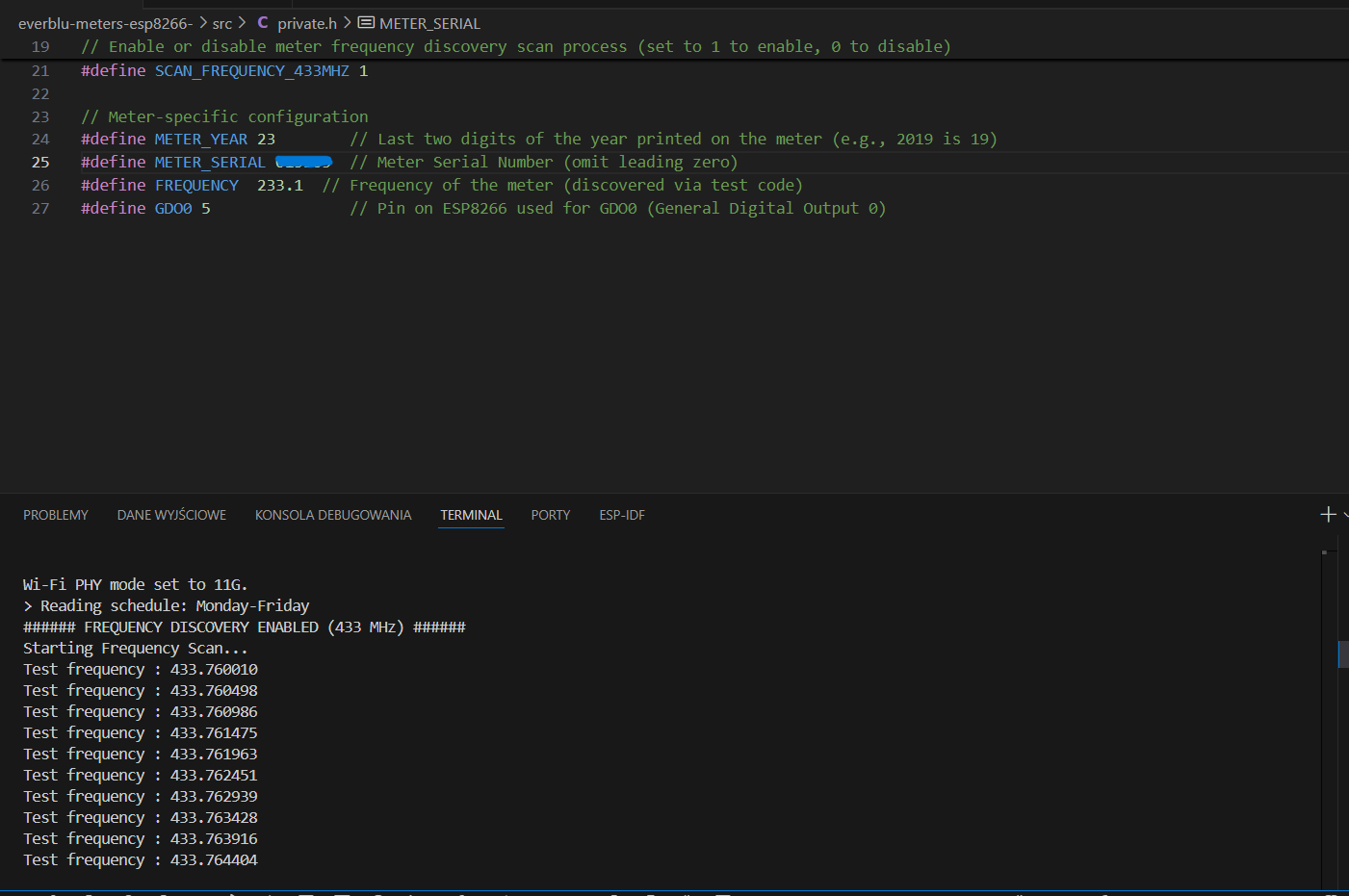

Hello. I can’t find the device’s frequency. How do I change the search range? It’s between 43.76xx and 43.8xx. Where can I change this range?

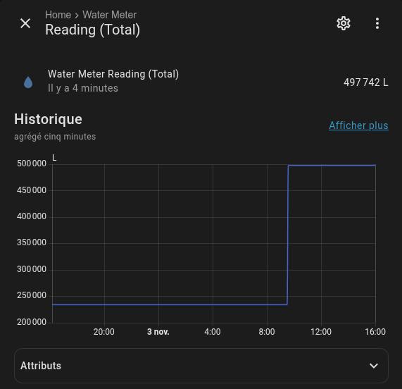

Hello Richard,

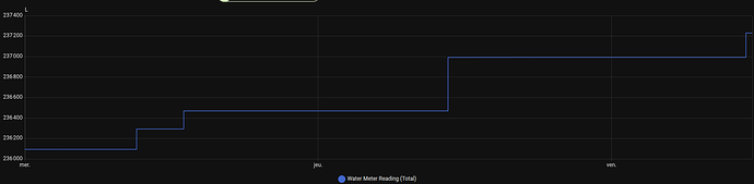

Thanks a lot for your work. Your post here made me dig up the project I abandonned several months/years ago…
In fact I had build and uploaded the code to he ESP with your method succesfully last friday. The readed values on the Itron seems to be relevant (234kL)

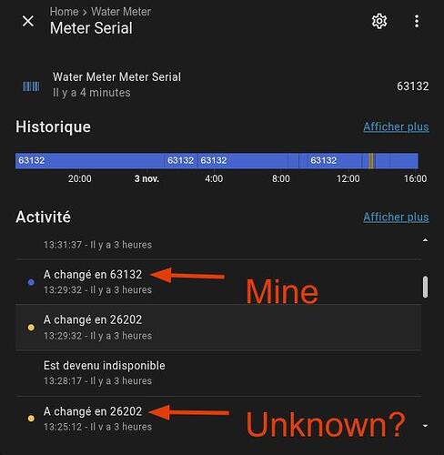

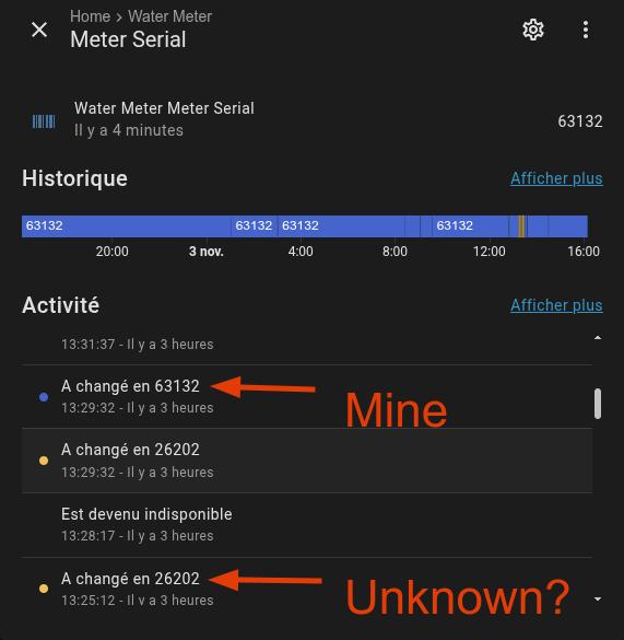

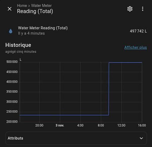

But today, when trying to force another Reading request from HA side I had the suprise to read a totally different value (497kL) wich seems to provide from another Itron (near from my house I think)
Unexpectedly, the serial Number seems to have changed. However It is hard specified in the private.h file?
Have you got any idea?
The different serial numbers:
Hello @Richard.Huish
Good news, It’s working for me now.
I don’t know exactly what has solved the issue, but it seems to be the EEPROM reset function… and probably defining the Frequency into the private.h file.
Another time. Thanks a lot for your work!

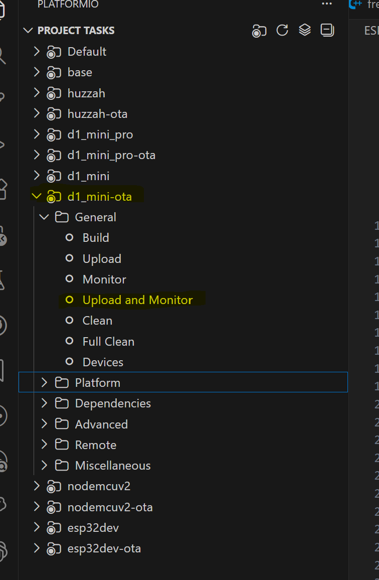

I marked this variable env:d1_mini-ota and hit the Upload Button in VSCode.
What can be the problem?
@smartmatic Can you post a issue to the repo in github please?
From the images you posted it’s saying it timed out, did you try to upload more than once, to make sure the esp was not “busy” the first time?
Can I also check you used the update button highlighted below:
