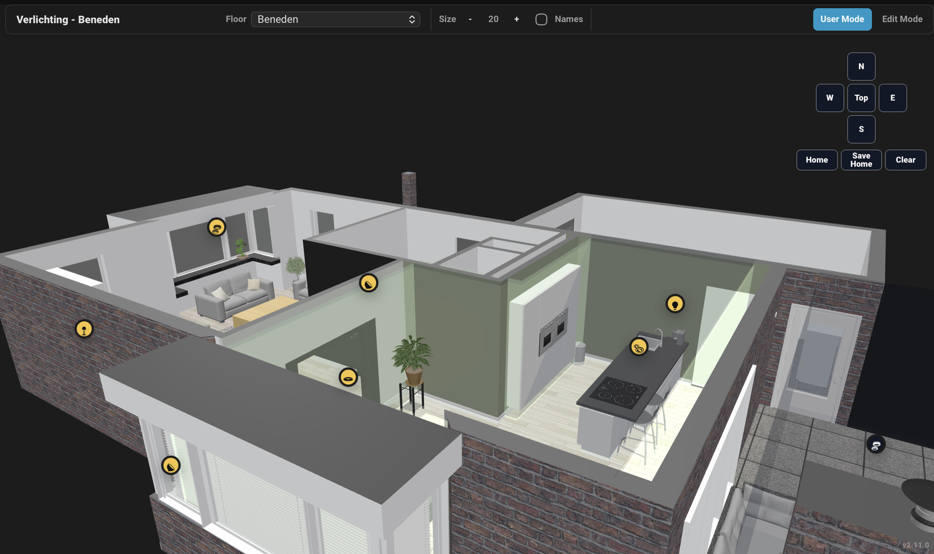

This is awesome! It’s quick on all devices and full of options.
I do have a few suggestions for improvements:
  1. Would it be possible to set the X and Z coordinates for the areas using decimal values? I’m currently unable to get the walls properly aligned.
  2. Would it be possible to hide the navigation buttons (N, W, E, S, Top, Home, Save Home, Clear) in the UI? They take up quite a lot of space on mobile devices.
