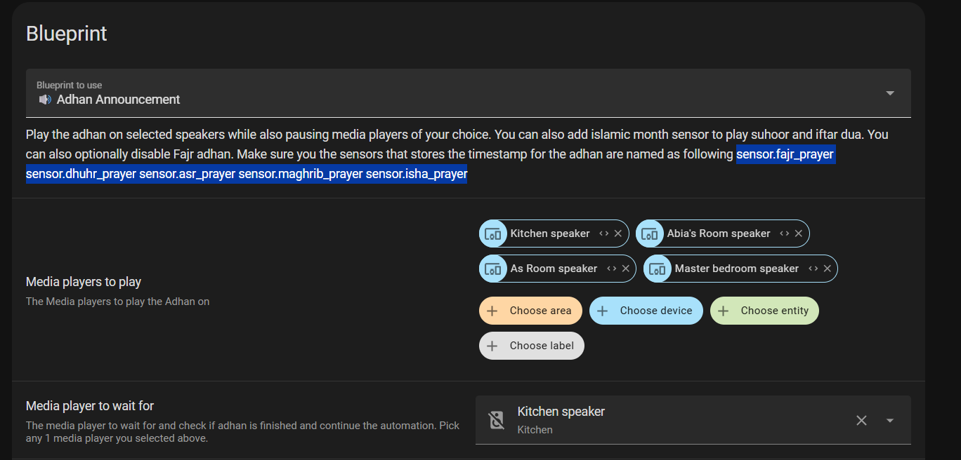

I have been using this for a couple year now. It’s been working great. Recently I moved to a new place. I only have one smart speaker and no other device to add under media to pause (which aparantly is mandatory).
Are you able to help me with a template which does not require media player to wait for? Or is there a way I can edit to remove this logic?
Appreciate your help.
W salam,
You can just select the same media player for the media player to pause.
Let me know if that works for you
Thanks brother. I made those changes. Now I notice this is not getting triggered. I see the Islamic Prayer Times sensors are working and correct prayer times are displayed on the dashboard. When I checked the traces for the Adhan integration, I don’t see any activities.
hmm, is the automation enabled? can you also share configuration and if possible any traces

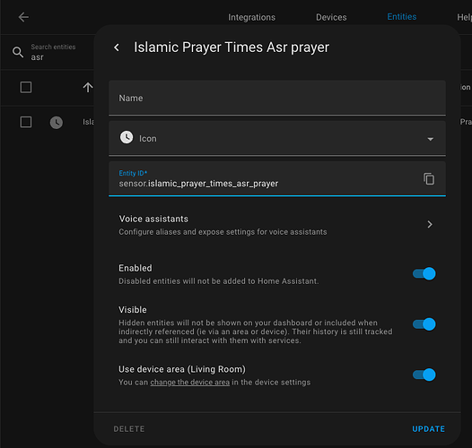

can you check the entity_id of the sensors and check if it is same? if its not, manually edit the name to the proper ones.
I see for Asr it is sensor.islamic_prayer_times_asr_prayer
Where can I update these?
Can I update here?
yup, edit that to look like sensor.asr_prayer. all the proper names are listed in the description of the blueprint.

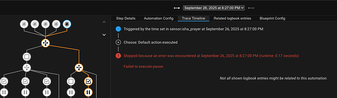

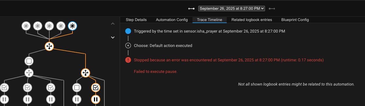

Why?
its failing because it is unable pause the media player. probably because its empty even though it should still ignore the error and continue forward. I will take a look and update you. if you can, can you try selecting a media player to pause.
I have updated the blueprint and works as expected with my setup. Please reimport the blueprint and let me know how it goes.
