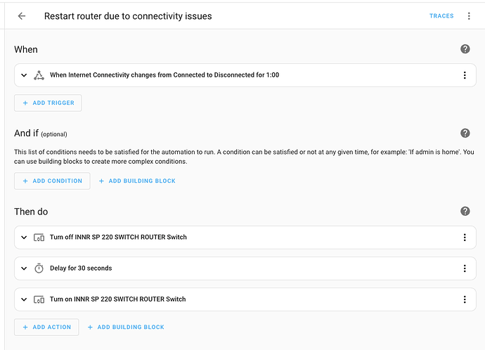

Did something similar… Seems to work =)
Using a Zigbee smartplug that the router sits on since my router sometimes cracks up and freezes wifi. I have a bunch of Shelly plugs but not for this…
Added the Ping integration in HA. Added 3 binary ping sensors like above - Google, Cloudflare, Quad. Then created a group for those 3 sensors and if any sensor is up / has internet connectivity / can ping its host then there is connectivity. Added an automation on top of that which trigs on the group going from Connected to Unconnected for more than 60s, which then toggles the Zigbee smartplug to restart the router.
Zigbee smartplug configured to always start with power after a power failure.

1 question: did you use name or ip? like www.google.com or 8.8.8.8?
I used IP.
