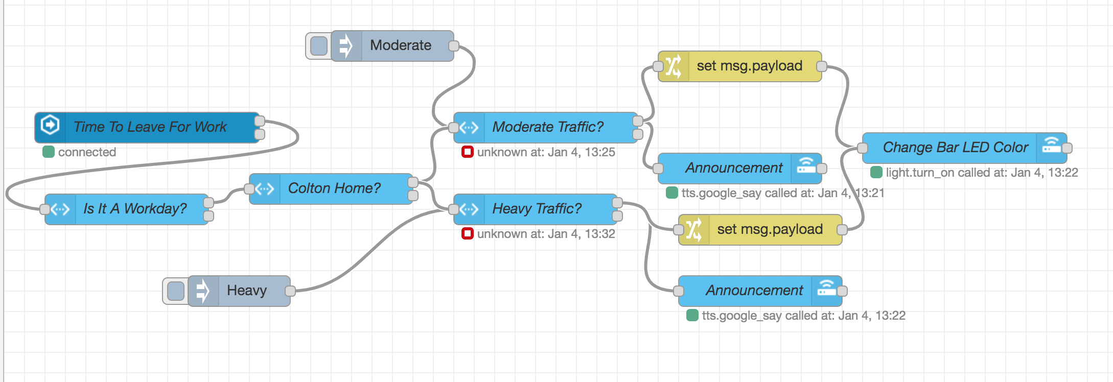

I am trying to recreate this via Node-Red and everything is working except checking for the traffic density sensor. It only shows unknown. Can you tell why?
Sensors
- platform: waze_travel_time
  origin: HOME ZONE
  destination: WORK ZONE
  region: 'US'
  sensors:
    time_to_leave_for_work:
      friendly_name: 'Time To Leave For Work'
      value_template: >
        {% set t = strptime(states.sensor.time.state,'%H:%M') %}
        {{ ( t.hour + t.minute / 60 ) > ( 7 - states.sensor.morning_commute.state | int / 60)
    traffic_density_to_work:
      friendly_name: 'Traffic To Work'
      value_template: >-
        {% if states("sensor.time_to_leave_for_work") | float >= 26 %}
          Heavy
        {% elif states("sensor.time_to_leave_for_work") | float < 26 and states("sensor.time_to_work_me") | float >= 22 %}
          Moderate
        {% elif states("sensor.time_to_leave_for_work") | float < 22 and states("sensor.time_to_work_me") | float >= 10%}
          Normal
        {% else %}
          unknown
NODE-RED Flow
