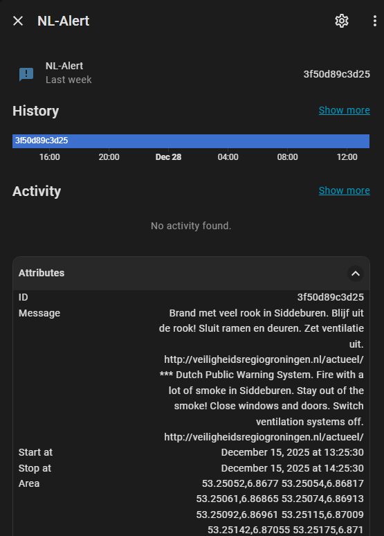

I also use https://api.public-warning.app/api/v1/providers/nl-alert/alerts as the source for NL alert. This is the official NL-Alert endpoint also used by Actueel | NL Alert.
Using a REST-sensor I poll this endpoint every five minutes with this YAML configuration:
- resource: https://api.public-warning.app/api/v1/providers/nl-alert/alerts
  scan_interval: 300
  sensor:
    - name: NL-Alert
      icon: mdi:message-alert
      value_template: >
        {{ value_json.data[0].id }}
      json_attributes_path: $.data[0]
      json_attributes:
        - id
        - message
        - start_at
        - stop_at
        - area
Then I run an automation every time this sensor is updated to roughly determine if the alert is applicable, and turn off or on ventilation if it is specified in the message.

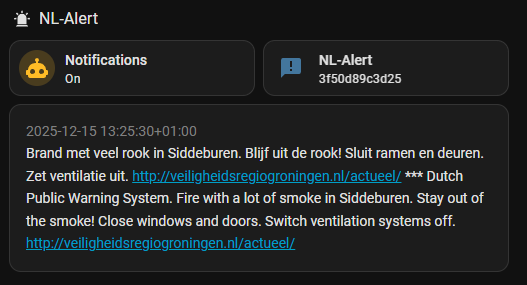

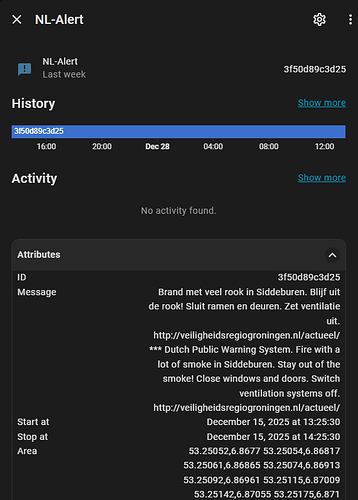

This gives you a sensor that will look something like this:
And can be integrated into a dashboard with a markdown card:
