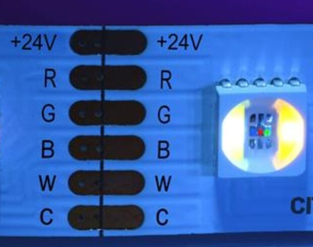

Watch out if you want separate colour temperature control on the white LEDs. Some RGBWW strips will only do warm white (WW), while cool white will be handled by mixing the RGB LEDs. The Quinled site linked above has an article explaining this (halfway through the page here).
Safer to search for RGBCCT and to ensure that both the strip and any controller you decide to go with have 6 connections:
