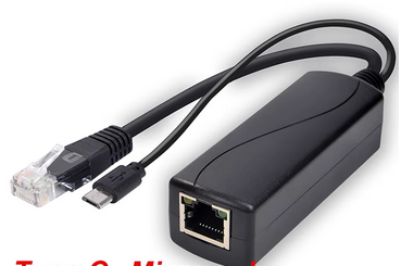

Or take a esp32 board with ethernet and a POE to usb-cable to power the esp32 with that adapter.

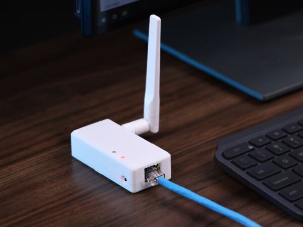

I'm using these as Bluetooth proxies (using ESPHome). PoE and a very good external antenna.

I have a GL-S10 BLE that works very well as a Bluetooth proxy with ESPHome firmware.
I am not currently powering it with POE, but that is supported by the device.
