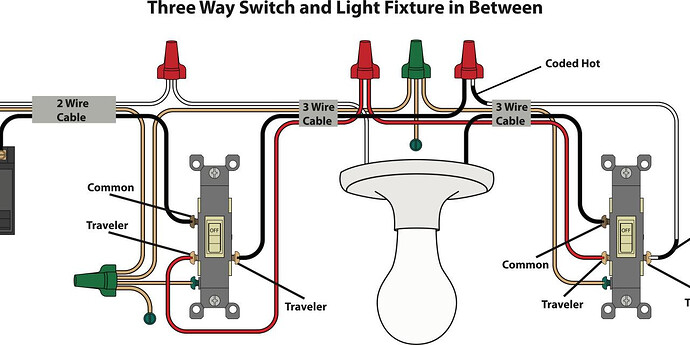

I have a 3way switch that uses the following wiring:
The problem I’m running into is that in this wiring configuration the switch after the light does not have a neutral in the box.
With my other 3-way switches I was able to use Jasco Zwave switches with an Add On switch. This solution won’t work in this case since the Add On Switch requires a neutral wire.
Does anyone have any have any other suggestions on how to wire this switch?
