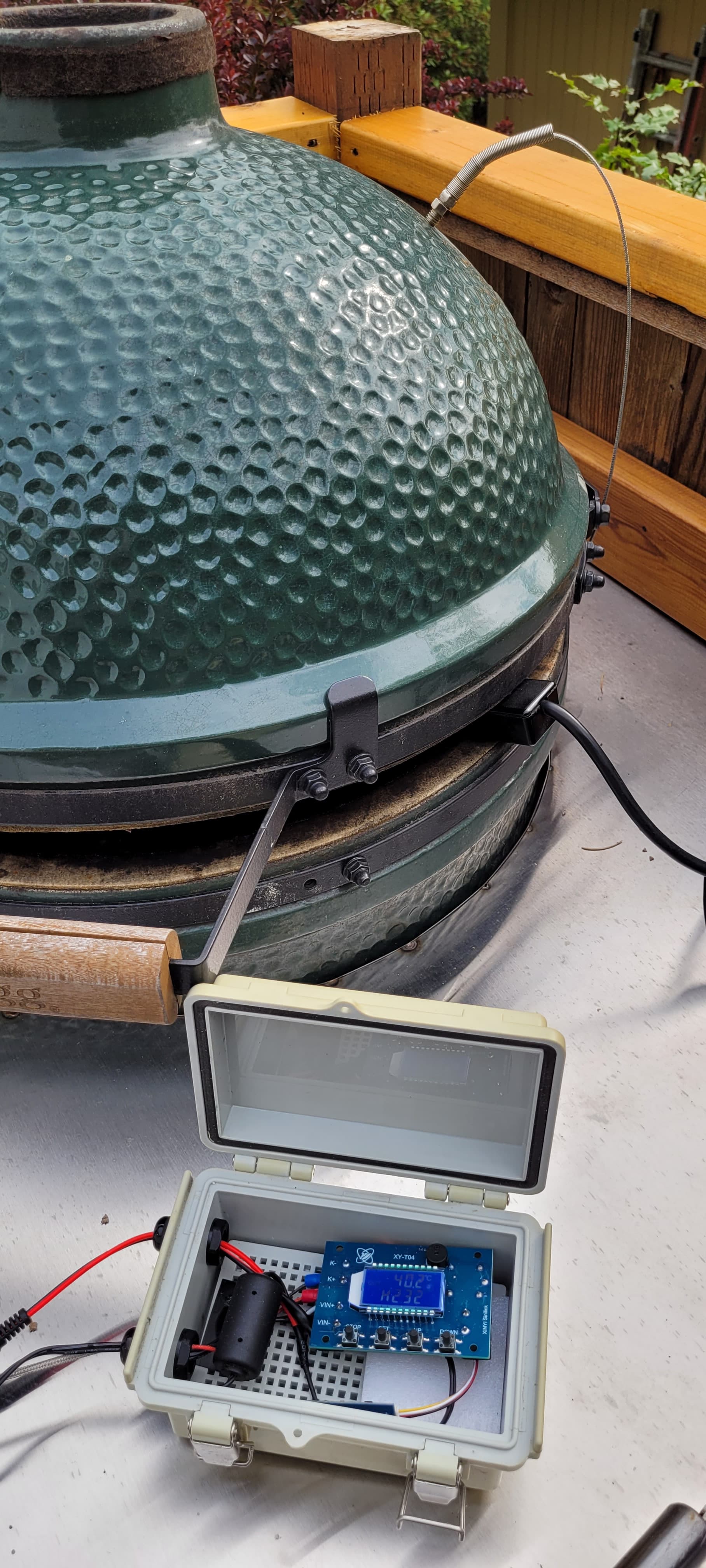

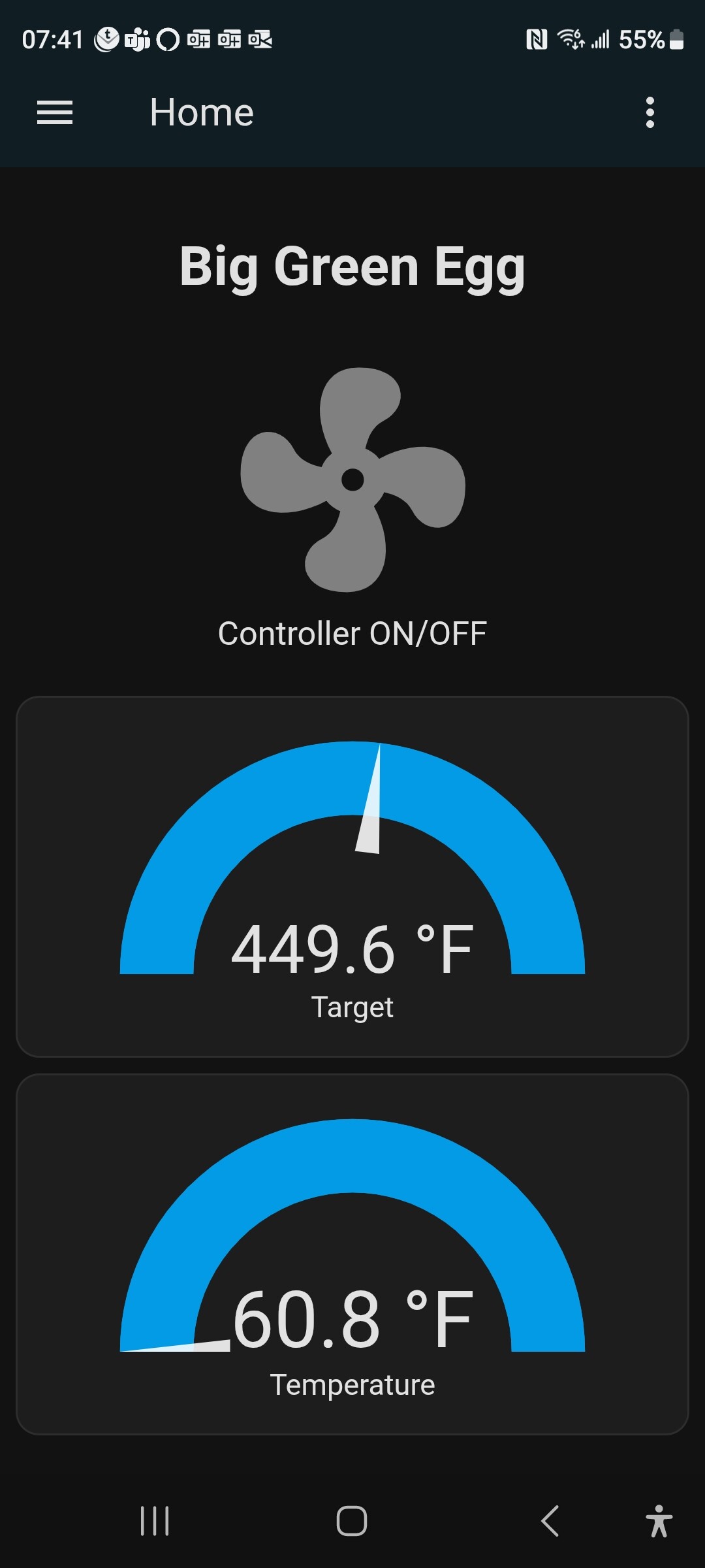

I’ve successfully reflashed ESPHome on the Sinilink XY-WFPOW module that comes with the XY-T04-W K-type thermocouple controller board. There is an on-board relay that turns a blower fan on/off. Had to purchase a different thermocouple model, one with a longer probe and carefully enlarge the existing temp probe hole in the ceramic lid.
This configuration exposes the raw ModBus registers as sensors and controls. I’m working on a new climate platform so it can be controlled via a climate card.
This configuration includes a thermostat climate component to easily control and monitor the BBQ temprature.
Thanks to @framenic for getting me started.

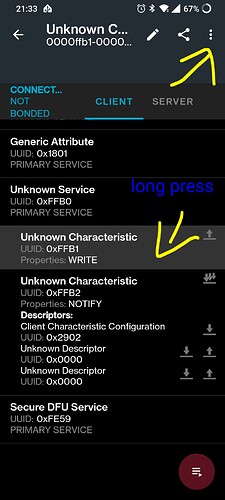

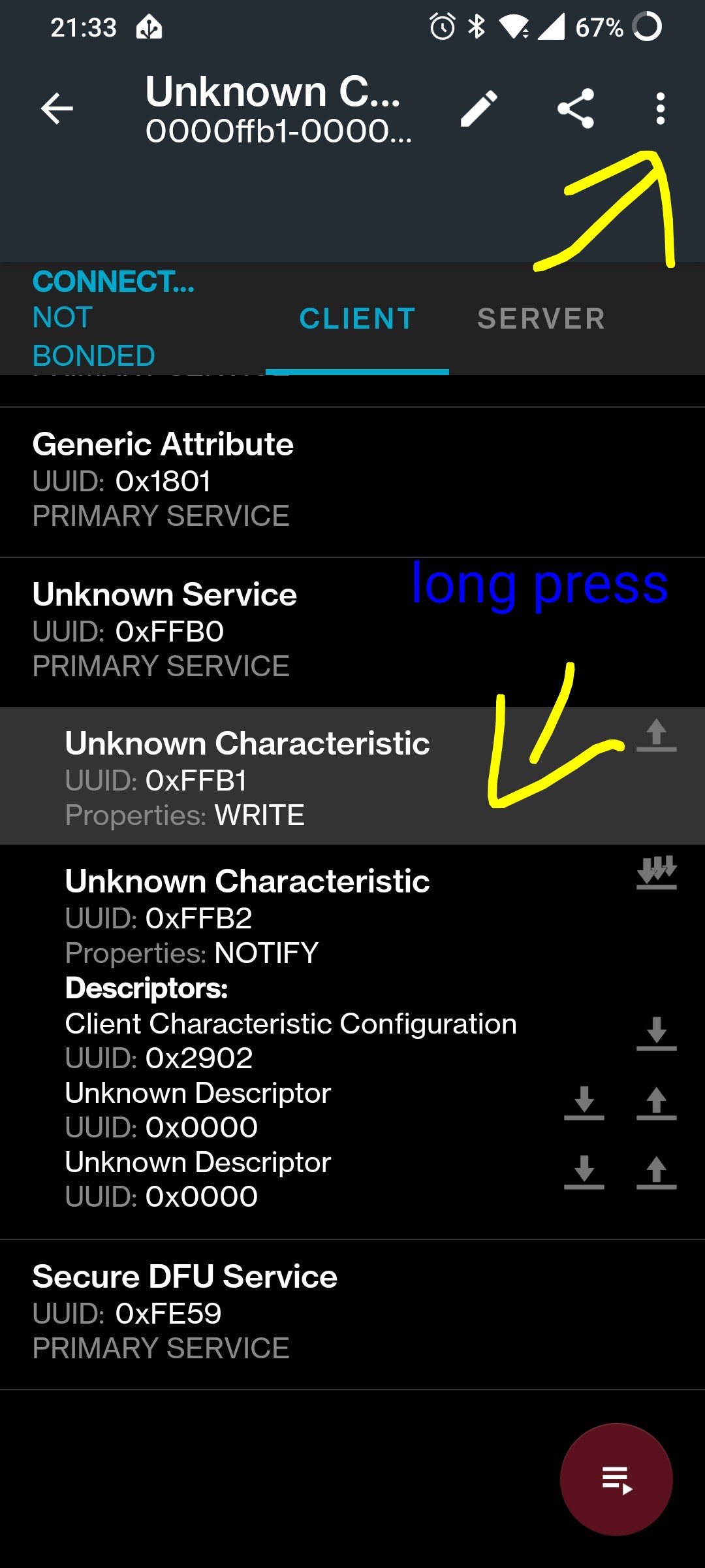

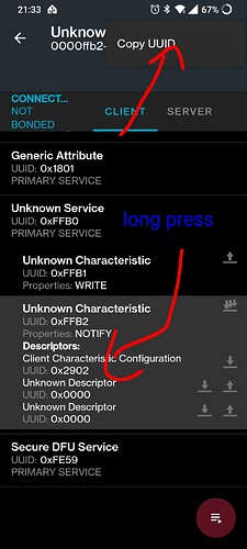

From a BLE standpoint, I’m curious. How did you find the uuid’s? I didn’t have to change them for my device so I assume they’re not unique like MAC addresses but I didn’t see them in the logging.

I used NRF Connect App from Nodic Semic Conductor on my phone. There is some kind of scanner. Then you can connect to device. In the three point menu there is one entro “Show log” and in this log I found the necessary information.
Best regards
Werner

For anybody that gets stuck:
  • NRF Connect app on Android will show you the MAC address and UUIDs you need.
  • NRF app might give you hexadecimal UUIDs (like 0xFFF0). I converted them to 128-bit format (like 0000FFF0-0000-1000-8000-00805F9B34FB).
  • Look for a sensor that has a value that changes. In my case, this “characteristic” was the only one like that. The probes come from different bytes in the total value. I couldn’t figure out which value was changing in the app on iPhone. In the Android app selecting “Enable CCCDs” let me see the value on the one characteristic I needed to determine which one it was.
  • The hexidecimal conversion I needed was different than the previous examples in this thread. I gave chatgpt the bluetooth value along with the equivalent reading from the BBQ probe display and it gave me something that worked.

to find uuid with nrf app , long press a box ,
and click three dots on the up-right and copy uuid
