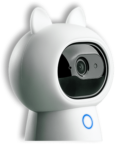

You might want to look into the Camera Hub G3 then as it should cover your needs:
The other option is the Switchbot version:
Thanks for the info, I’ll check them out :slightly_smiling_face:
