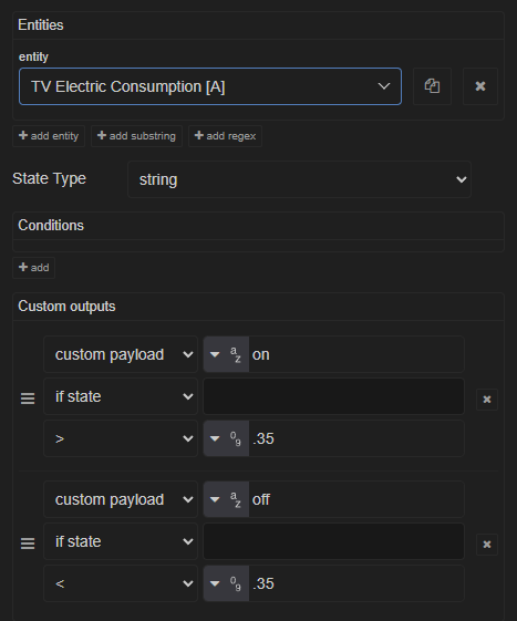

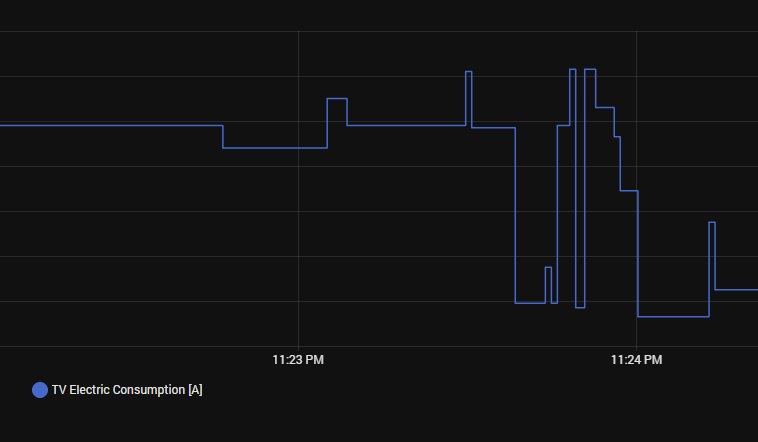

I use these and love them, they definitely report energy usage:
I use for automations in NodeRED when over or uder certain (amp) usage levels to detect things like TV on vs. just in standby.
they also report changes to HA (at least the ZWave model) in near realtime:

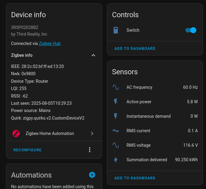

Just got some of the Thirdreality Zigbee plugs. They’re working great, but I haven’t used the power monitoring functionality.
