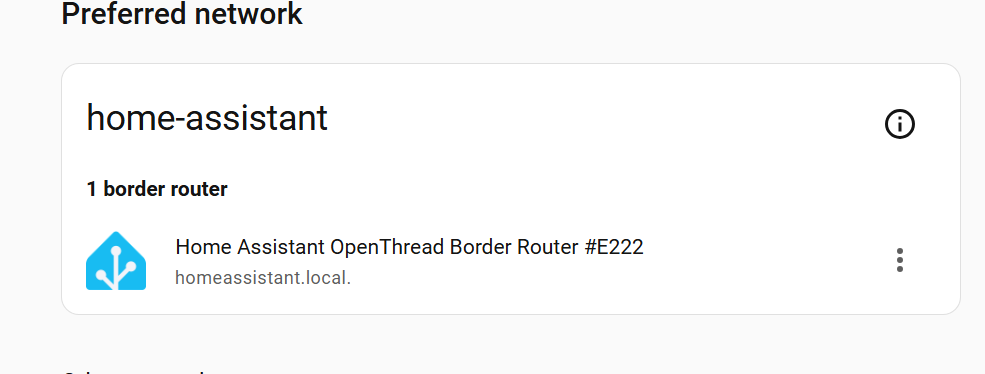

This shows up in Thread now:
Tomorrow I will try to add a Thread device.
