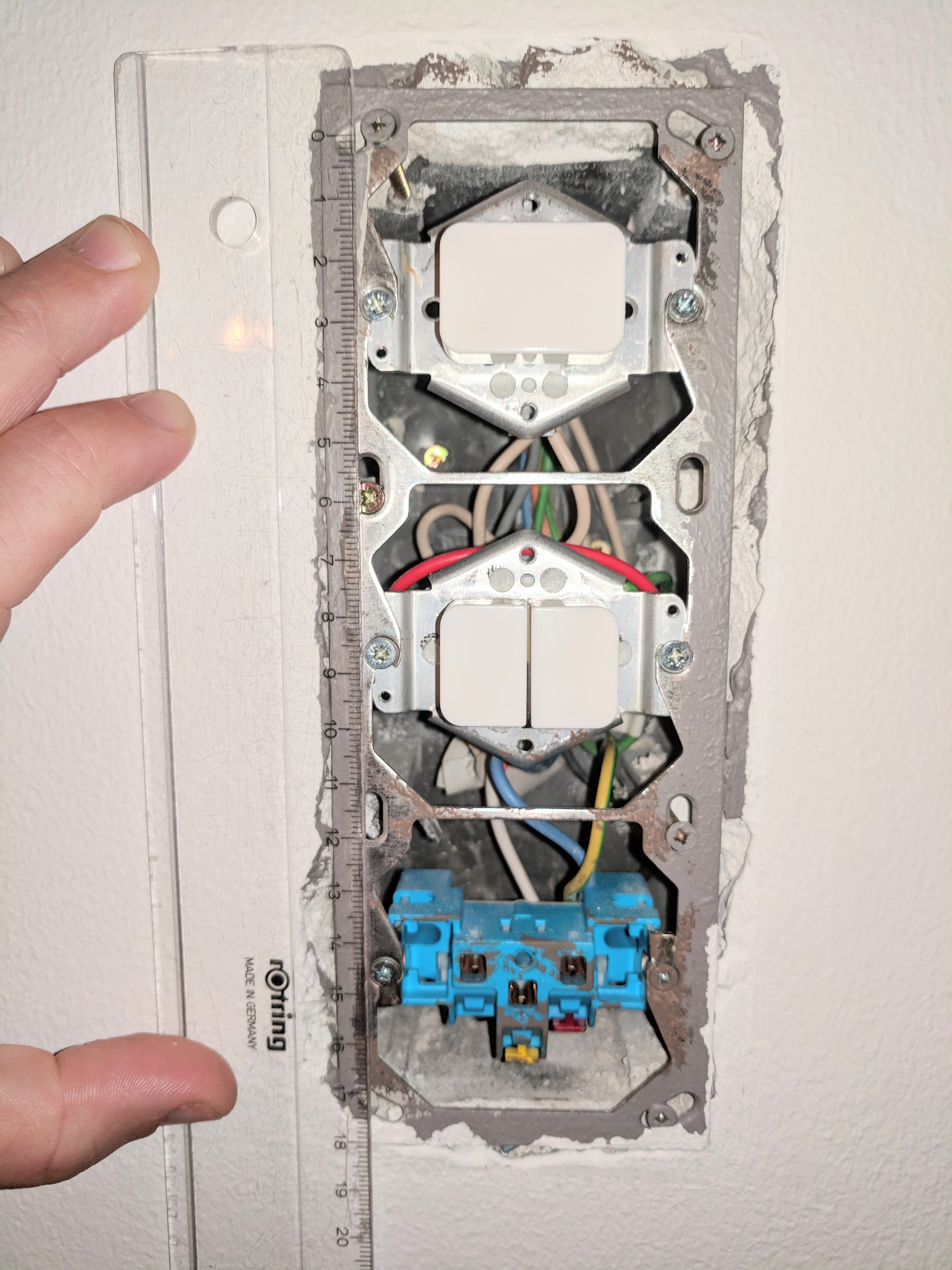

Ideally I’d hide it inside the pattress box in the wall. Somewhere in here:
So the smaller the better!
