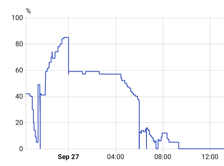

Interesting. I’ve been using Eve Energy (HomeKit) for a few years, but later switched to Sonoff TRVZB. When Eve converted to Matter, they didn’t expose all entities, e.g. the calibration. It feels like they stopped caring about the product and therefore its integration into Matter-based smart homes.
Their internal regulation isn’t too bad, though. Here’s a screenshot from last night showing the last one I still have installed (in that room, the TRVZB doesn’t fit because it’s too long). Some of that “smartness” might come from the versatile_thermostat regulation, but it clearly shows that it’s not just a binary control:
I find it very useful – though the more I rely on Home Assistant, the more issues I face when either HA goes down or (more often) the Zigbee or Thread meshes act up. I really wish there were more redundancy. So I completely understand your desire to use hardware that can operate independently from HA.
