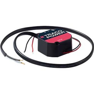

Recom got some nice and tiny power supplies - alone from the price I would pack that in your category “trustworthy”
