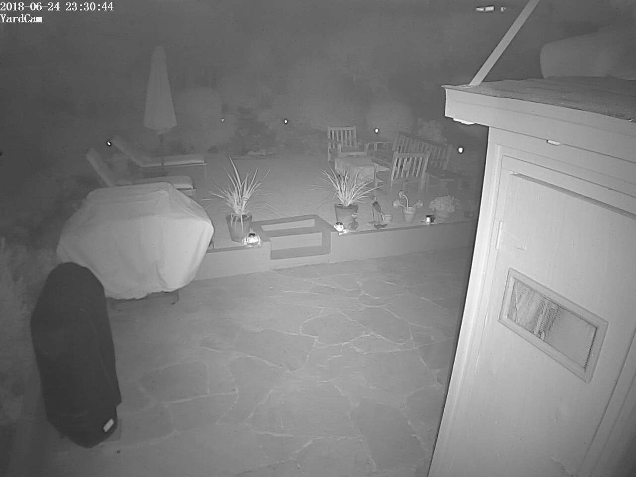

I run a combination of Foscam and Amcrest (and 2 Fire Tablets) into Zoneminder (standalone Ubuntu server) and then linked to HA. I prefer the Amcrest. I’m up to 13 cameras if you don’t count the pi Zero’s that I just play with.
Here are the exterior ones; Looks like my front port got shifted a little:
