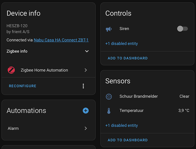

I like ā€œFrientā€ (Develco) smoke alarm. It’s European based company.
Device have temperature sensor, that helps me see if the device is working and in range.

The Frient/Develco and Bosch I mentioned before have a binary sensor with type smoke that will trigger on detection.

Yes, I have them connected to ZHA now.
And these are the options for the Develco/Frient Smoke and Heat detectors:
