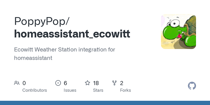

That’s encouraging. I have a GW1100 gateway and a series of WH31 sensors on the way. Is there a configuration guide for ecowitt → HA integration you can point me to? I can’t seem to find anything in searching that shows a direct connection to HA, all I’ve seen is the ecowitt2mqtt proxy which seems a bit clunky (but I’ll use it if that’s the recommended option).
You install via HACS, this is the version I run
You rock. Thank you. Got it all up and running!
