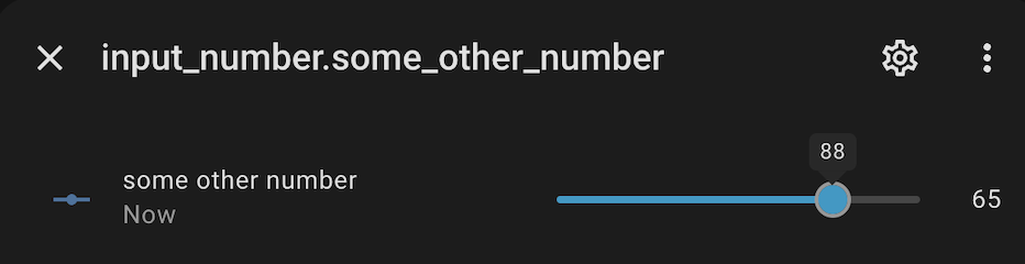

The question is if there a way to refresh the slider back to the current state?
For example, in this case I tried to select 88 but the validation reset it to what it was before.
This is not about setting the ranges on the input_number. Might want to allow just odd numbers, for example.
I’m not exactly clear on the best UI for this, but is there any way to get the slider to refresh back to the 65?
Of course, I could have a text field show up that says the selected value is invalid, but having the slider snap back might be more of a clue.
And, there’s no other way to do the validation other than in that post linked above that uses two entities or with an automation like this, right?
