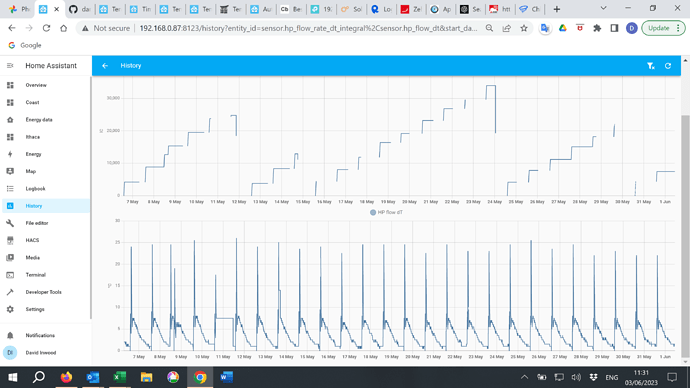

Can anyone help diagnose a recent problem with one of my Reimann Sum integrals? It worked fine until a few weeks ago. It was giving me an estimate of the heat energy from my heatpump going into the hot water, so there is code behind the source sensor using flow rate & flow/return temps. However as source: sensor.HP_flow_rate_dT has good data (see image) I’m assuming that is all OK.

and the recent history of the source sensor & it’s integral look like this:

There’s a fix coming out in 2023.6…introduced in 2023.5.
