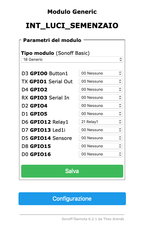

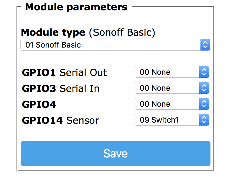

ok here is a snapshot from the console:
And here is a snapshot of the module config page:
Note GPIO14 is in use as I have a momentary switch to also add physical switch operation of the module.
Is this what you need?
Thanks.

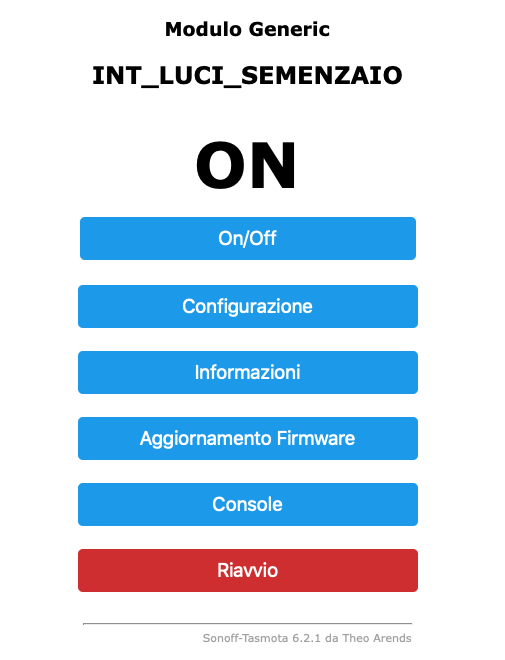

This is how it is shown in HA
28
and this is what, at the same time, the tasmota web page reports.
No, not really. I will not use a phisical switch …
But maybe I have to change the GPIO I am using … (?)
