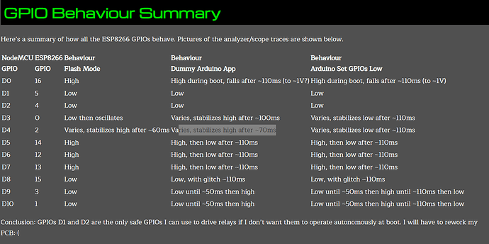

I have a bk7232 running on openbeken and it does the same. Probably a hardware limitation.
I seriously doubt the ESP8266 itself is holding a GPIO in a non-default state through a reboot. I don’t think you’ll find any chip that can do that.
That of course doesn’t mean a relay has to open during a reboot. Depending on how it is connected, what the default state of the GPIO is, what the pull-up/pull-down resistors are, and whether the relay is NC/NO will all affect the behavior observed during a chip reboot.
Blaming the chip itself for this behavior is misdirected.
More expensive but tuya? You paid too much.
MCU pins have all kind of different behaviours during reboot, if the relay trigger doesn’t have pullup (or pull-down), quite likely switching will happen. Independently how pricy the device is.
I use this when choosing pins in 8266.
That’s good example.
