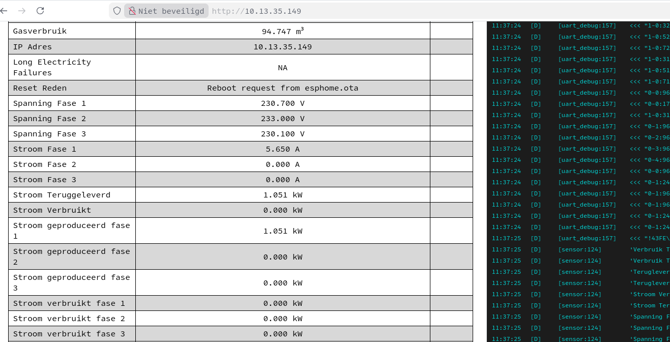

Very interested, as I’m running into limitations with my Belgian DSMR meter.
However, two issues:
your telegram is missing an id: or name: in your example dumping config.
Second, worse, on ESPhome 2024.2.2, I get:
Compiling .pioenvs/dsmr-meter/src/esphome/components/dsmr_custom/fields.cpp.o
In file included from src/esphome/components/dsmr_custom/dsmr.cpp:36:
src/esphome/components/dsmr_custom/dsmr.h:42:14: fatal error: esphome/components/sensor/sensor.h: No such file or directory
     #include "esphome/components/sensor/sensor.h"
compilation terminated.
I can try upgrading, do you expect a minimum version ?
Same problem on ESPHome 2025.6.3
@Xoliul, thank you for checking out the component. Just to clarify are you using the encrypted data in your meter?
No encrypted data.
OK, if you do have unencrypted data, let’s start debugging why you do not see data flowing from UART. 1st, did your last working version with original dsmr provided you working sensors in the HASS?

Thanks for the new release and also thanks to JeeCee for the hint to clean the files. I could succesfully build the new release after doing the clean up.
I don’t receive any data yet, but I think that’s a hardware bug. What I see when debugging directly on UART looks like “rubish”…
I can also confirm, that the component in the version 1.2.0.0 can be build with a text sensor only.
Is your baudrate correct?
Encrypted?
What meter type/version do you have?
I also have a belgium meter so for some reason It wouldn’t work for me until I read through the source and noticed that the type for gas needs to be defined as
gas_delivered_be
Even with custom telegram it gave me a float error, so at that pointed i read through the documentation and noticed that the type for gas_delivered for Belgium users was different it should be gas_delivered_be also in the regular dsmr once i did that everything worked for the gas meter.
If you like i can post a working config, or at least one that works for me.
