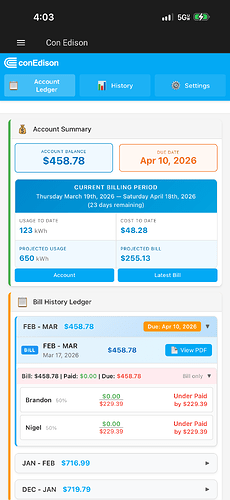

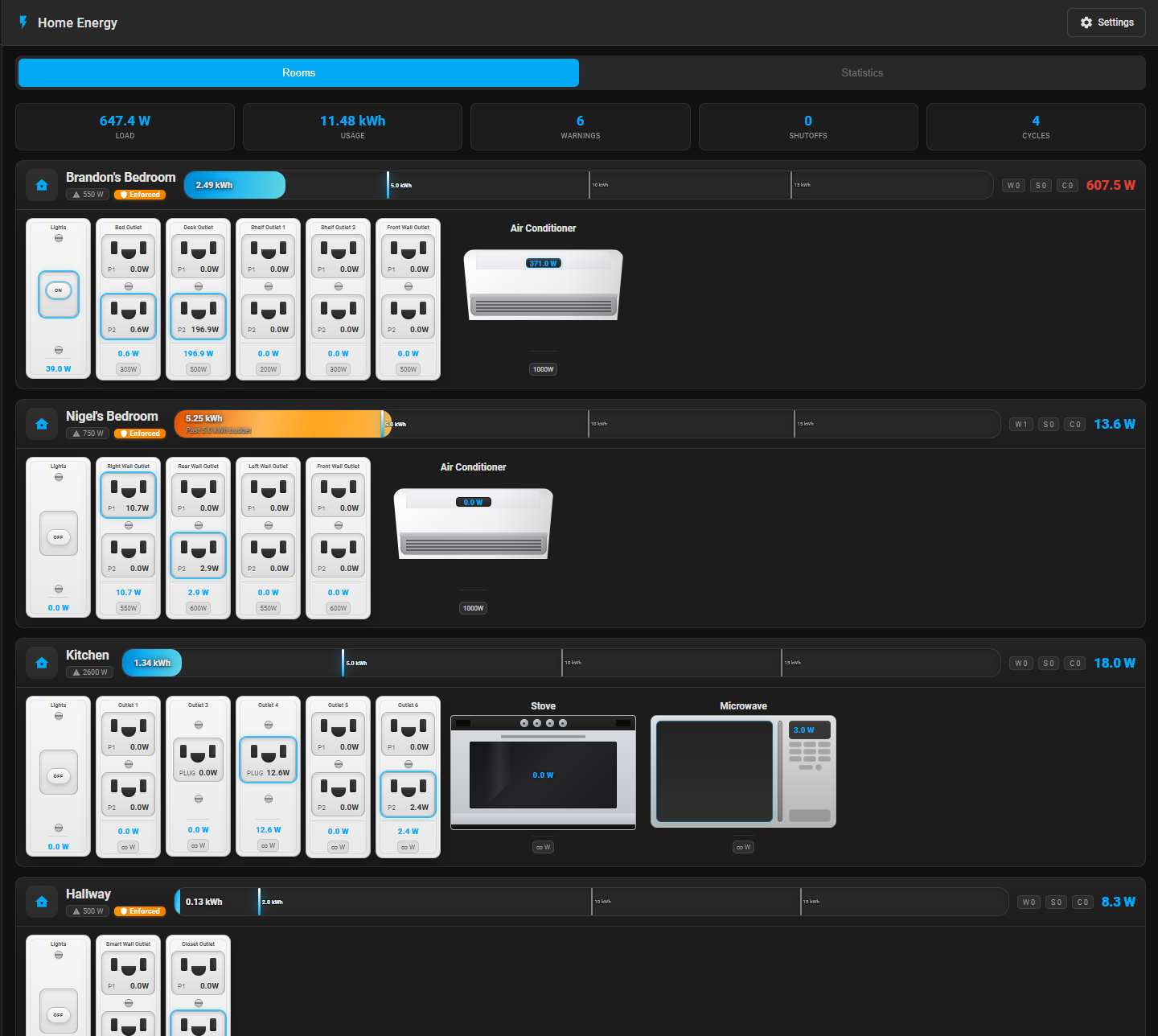

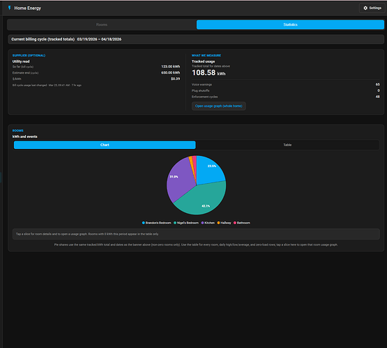

Your math may benefit a an integration i been working on, alternative energy monitoring and power consumption protection/enforcement. Been running it for few months working out the bugs needed just what you made among a few other things before i start releasing this
also i feel you may benefit from this small read Communicating from Addon to Home Assistant: MQTT vs Registered Integration - #2 by zodyking
Hi zodyking
Great to hear that you can use part of the work. Your UI screenshots look interesting and it seems like you already have a good data foundation for the predictions. Let me know how it works once it’s running!
Actually, this is also part of a bigger project on my end. I’m working on a custom energy management system for solar energy usage optimization.
And I will definitely have a read through your summary.
