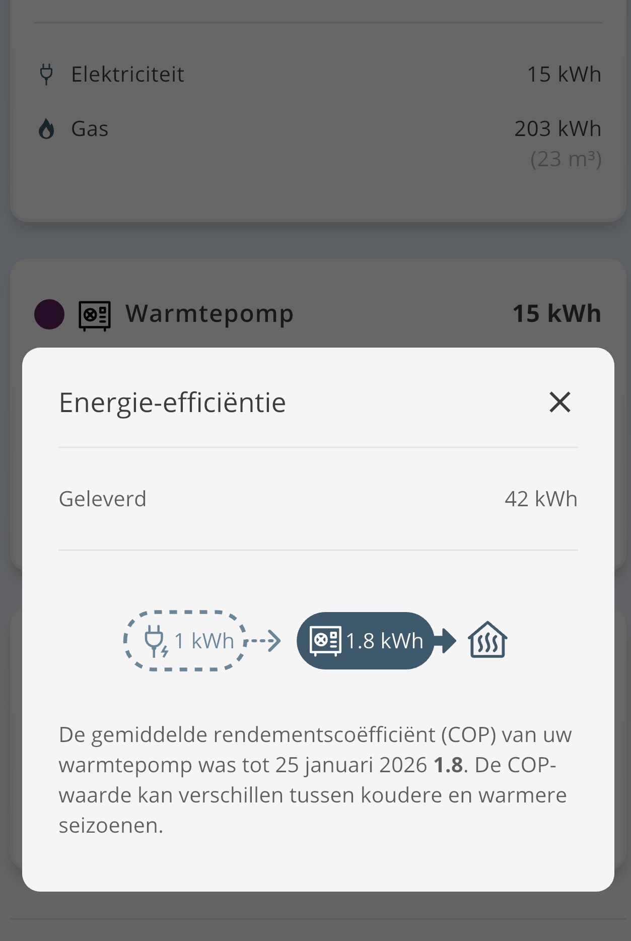

Apologies for the followup question, but I finally loved into my new house and got everything in Homeassistant. The challenge is now that the Integration only supplies “heating energy delivered” which is a combination of electrical + gas (i have a Hybrid system). Do you know how to get the COP of the heatpump? I am measuring the power consumed by the heatpump.
Based on the Remeha app I should be able to get the COP from the integration somewhere…

BTW, I’m fairly sure that the COP value that the Remeha app is showing is actually the SCOP value (so basically the long-running COP average).
As an aside: a COP of 1.8 seems a bit low, mine is 4.6 and I can’t say I have a home that’s exceptionally well suited for a heat pump (“okay” insulation and only big old radiators, no under-floot heating).
So you only have an Elga Ace and not a hybrid setup? sensor.elga_heating_energy_delivered in my case is the combination of heating energy electric + heating energy gas, so that makes calculating the COP out of that pretty useless.
My house is okayish insulated, but does have underfloor heating and JAGA low temperature radiators in the upstairs rooms, so should deliver a COP way higher than the mentioned 1,8 that it is delivering now. Will do waterzijdig inregelen and additional measurements soon.

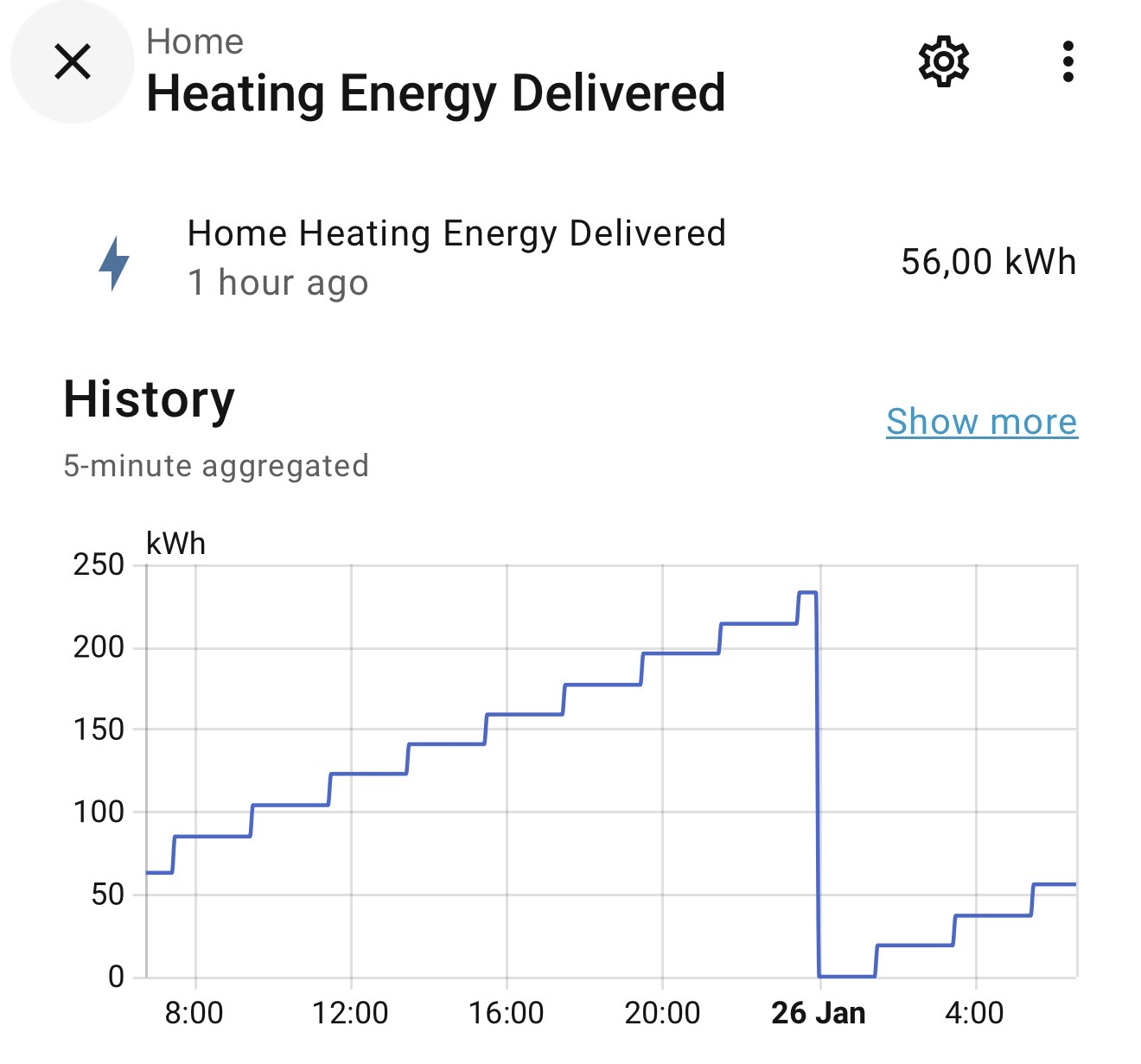

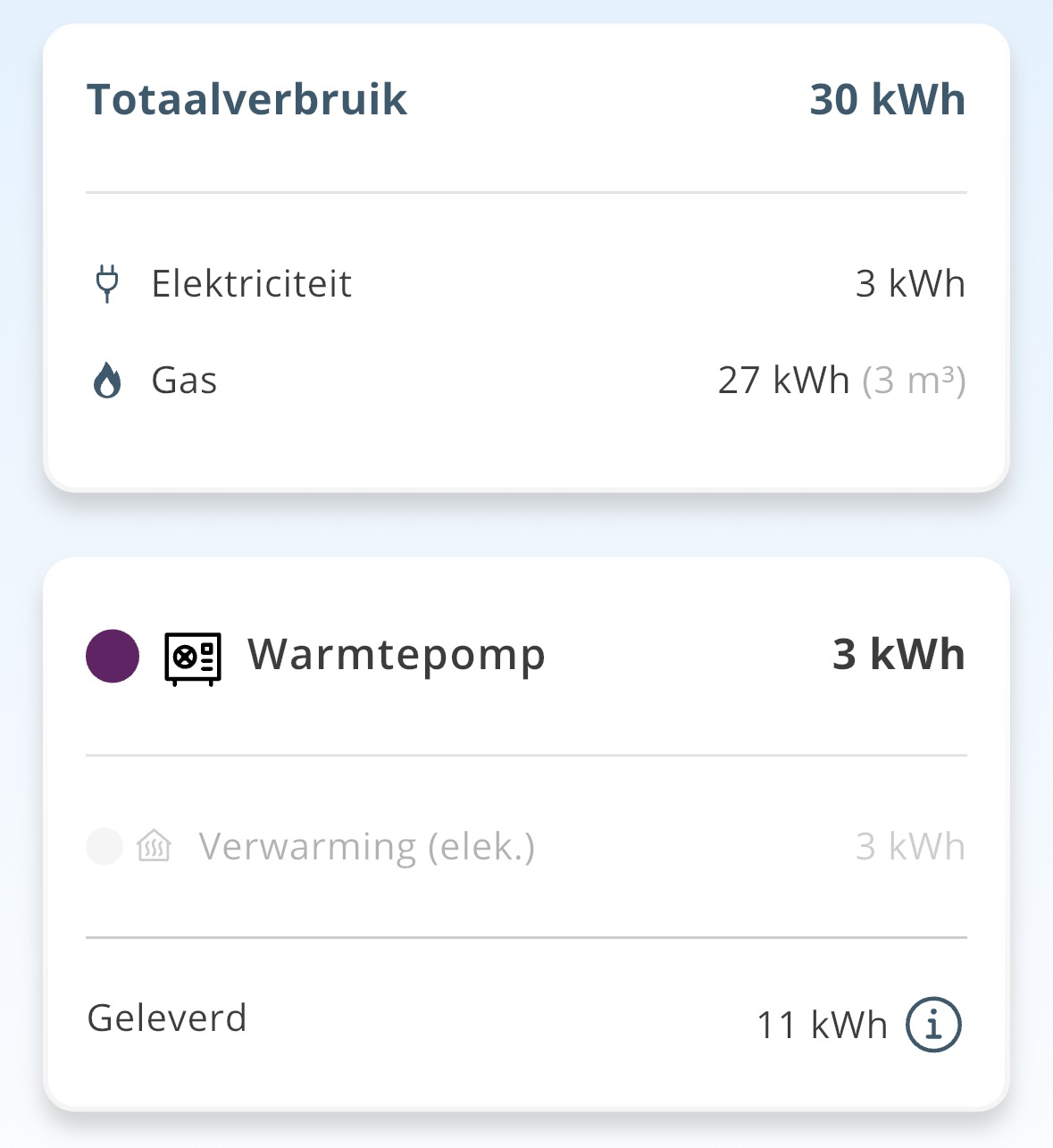

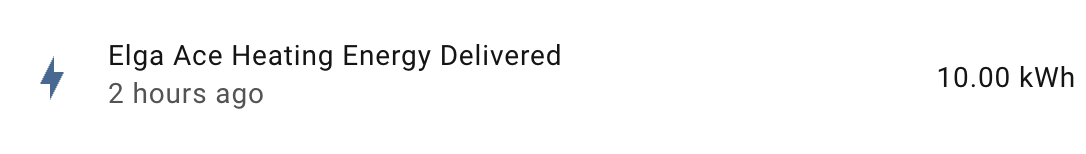

Are you sure that the heating_energy_delivered sensor is both electric and gas? Because it isn’t for me.
HA:
Remeha Home:

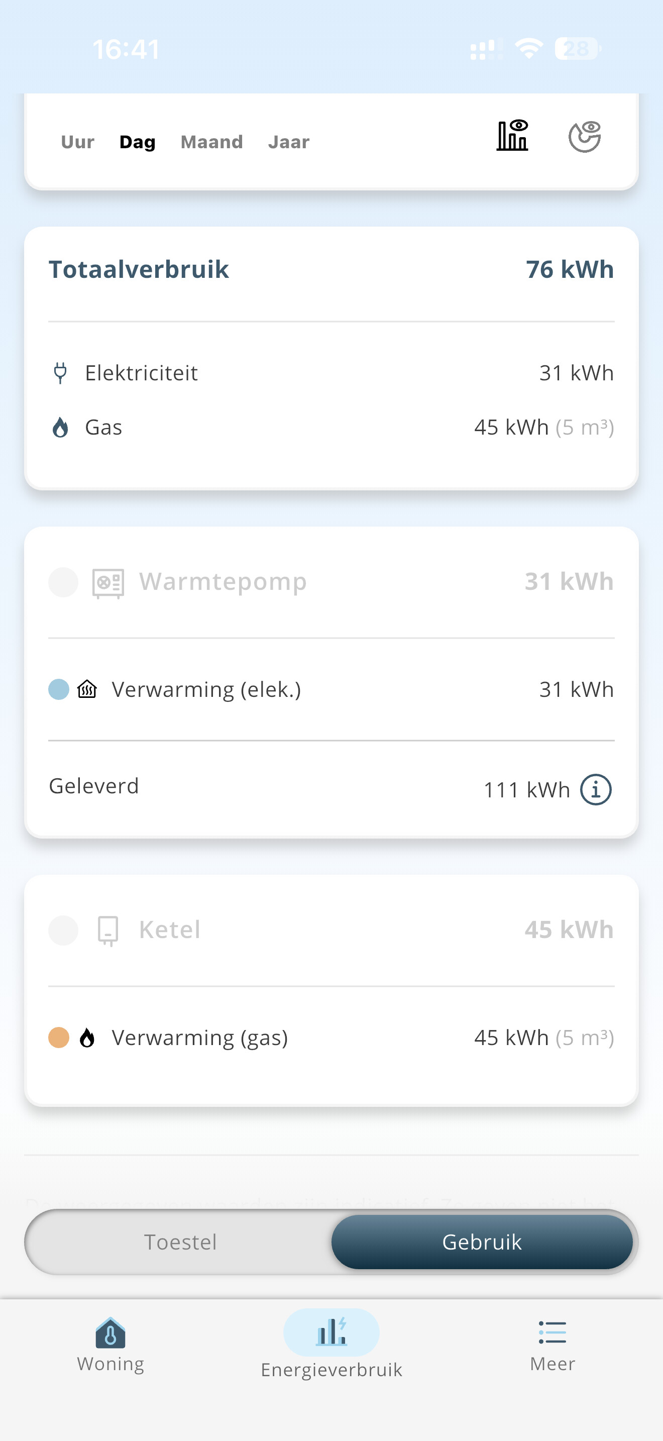

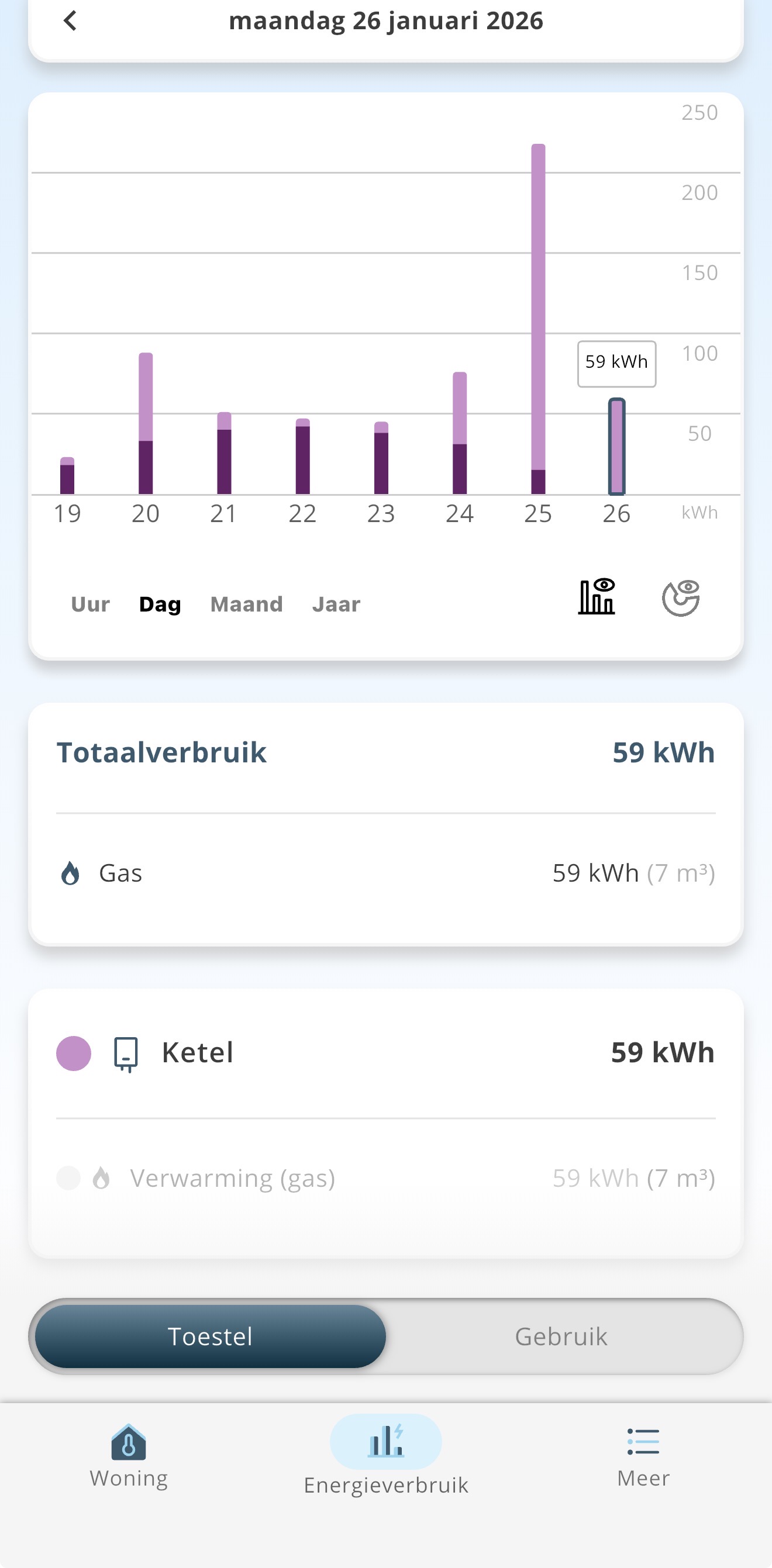

That’s really weird! Today my heating has been fully on gas and sensor.home_heating_energy_delivered_2 shows a value of 116,00 kWh. I also looked back on mixed gas/electric days and also in there the total heat delivered is the sum of gas + electrical. Based on what I am seeing however the app does show what I want (electrical heat delivered), but the integration is not showing that value so it is probably an issue with the integration
