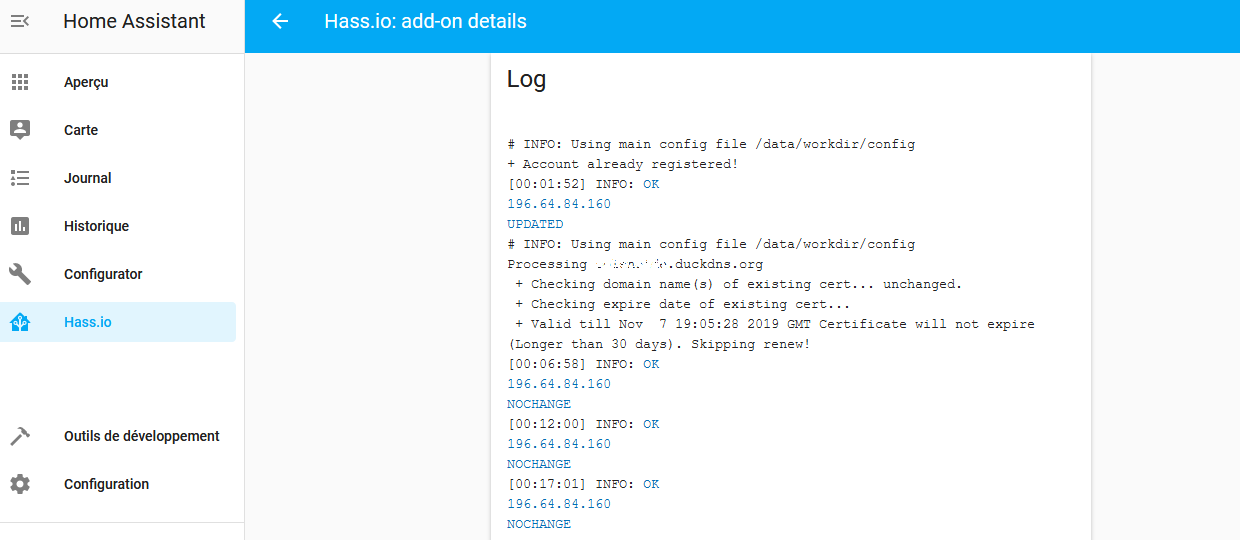

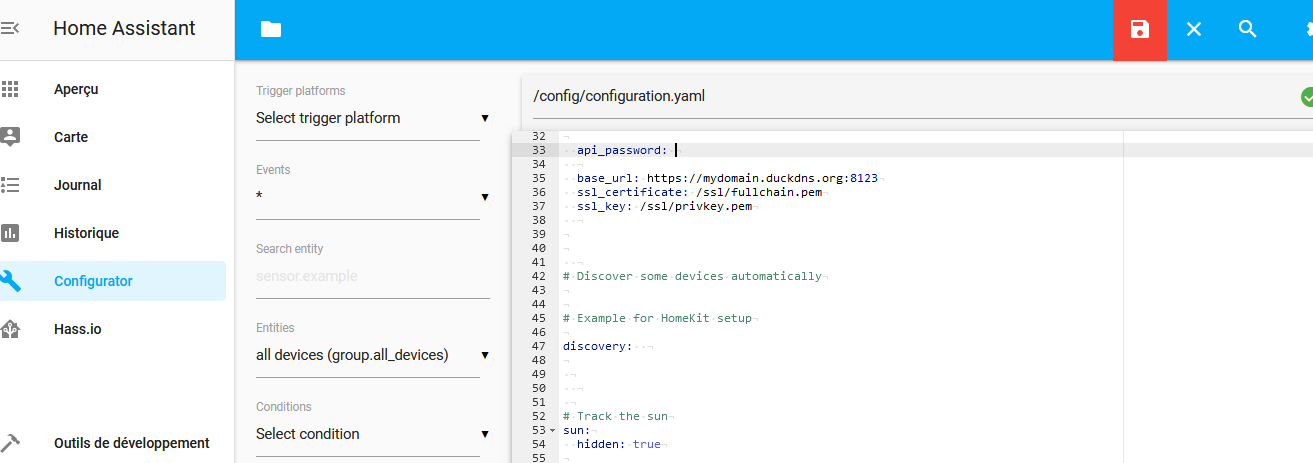

it is not working, i do not know what is going wrrong;
i am using duckdns and dnsmasq, add ons activated configuration well done as suggested but when i try to reach
"https://mydomain.duckdns.org:8123" impossible.
