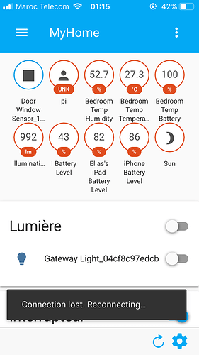

after two days of trying a lot of probabilities, finally i have remote access from cellular network, and that’s the problem, because that is the only access i have from the application on my phones, if i change to wifi i lose connction or i have to browse the “httpS://my.ip.address:8123” on pc only to get access.

this is what i get when connected by wifi, (connection lost, reconnecting…)

no on the pc’s browser i don’t have probleme, it is in phone’s application as i shown you.
