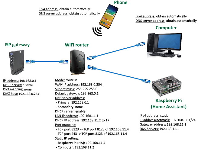

I tried to summarize my network details as much as I can in the following picture (I omitted some devices on purpose for the sake of clarity).
Companion app on my Android phone is configured with Home Assistant URL set to my DuckDns address (https://_________.duckdns.org:8123/).
To reiterate my problem, when my phone is connected to my home WiFi network Home Assistant Companion can’t connect to Home Assistant and display the error message can’t connect to Home Assistant.
In order to solve this problem, I’m looking for a free solution and won’t mind reconfiguring my network, tweaking Home Assistant or both.

It could be a quick config change. Like I said, the screenshot (which is still missing) of the setup screen in your Companion app is key. The information below is not enough.
Now,
If you use this address http://192.168.11.4:8123 from the browser of your PC, would you be able to connect to the HA? (Attention: use http, not https)
If you use the same address from the browser of your phone, when it is connected to your home wifi, would you be able to connect to HA?
If yes to both.
Grant location permission to your Companion app. Go into your Companion app, open the setup screen, plug in your Home Network WiFi SSID, and use http://192.168.11.4:8123 as your Internal Connection URL… and maybe play with the Prioritize Internal URL switch and see what works better.
If this works, then you don’t need AdGuard nor Dnsmasq, you don’t need nginx or any reverse proxy, and you don’t need to change your remote access setup (which is already working).

  1. You might want to change the DNS on your HAOS into 1.1.1.1 or 8.8.8.8.
  2. What’s the primary and secondary DNS, when you setup your DHCP server on your router? Or is your router only give you the option to enable / disable DHCP plus IP range? Note that, depends on your router, this DNS setup under DHCP may not be the same that your router would be using, which is your ISP Gateway.
  3. What exactly is/are the DNS server(s), that your PC obtains automatically?

  1. By default, the router LAN IP address but but it seems they can be manually configured.
  2. 192.168.11.1
