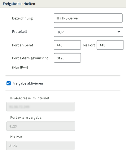

  1. In the fritzbox add an additional port forward for the nginx add-on. I use 8123 (external) and forward it to the nginx SSL port 443 (see III.3).

In the fritz.box I made these 2 port forwardings which create 4 entries:
Is this correct?
For nginx, also MariaDB must be installed (!) which I found out later.
In Step V.1, is the IP fix?
In Step V.2, in which format did you put the myFritz domain? I put ‘https://xxxxxx.myfritz.net:8123’. Is that correct?
Did the let’s encrypt add-on generate the certificates correctly?
You only need 2:
TCP external 8123 to internal port used for III.3 (default 443)
TCP external 80 to internal port used for II.3 (default 80)
No, if you use the add-on it includes everything you need. My instructions are valid for the nginx add-on. If you don’t use it your installation instructions are different and not covered above.
Yes
Yes

The 2 bottom port forwards seem to be from the IPv6. I deleted those in the fritz.box.
These are the settings now:

Here is my router’s port forwards to nginx:
Thank you very much! Got it working now.
The port forwarding was ok. But for the HTTP: access I had (have) the device name included in the address, for the HTTPS: it only works if I do not include the device name. I’m sure that make sense, … somehow …
