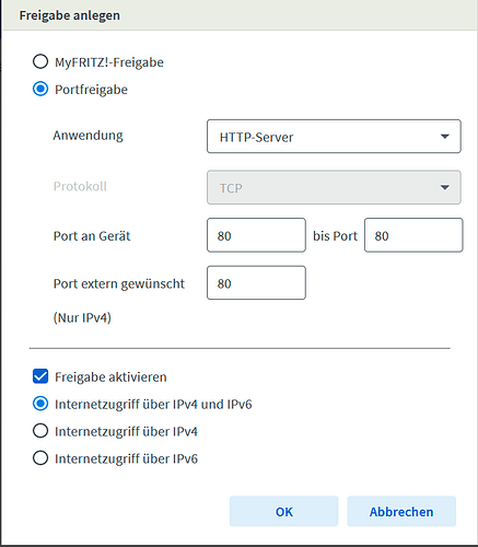

Hello Chris,
it looks like, you missed to create the portforwarding for IPv6. My provider is also 1&1 and I have a DSLite connection, means no native IPv4.
If you create your rule, then select “Internet access for IPv4 and IPv6”
You should get two entries.
One for IPv4 and the second for IPv6. Both ports have to be open, that letsencryp can create a new certificate.

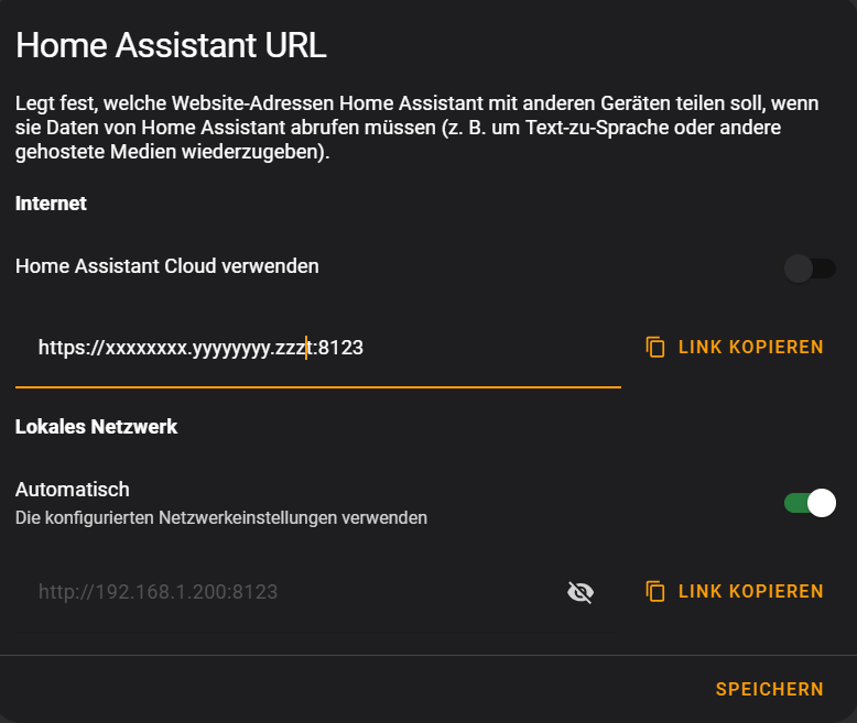

please can you help me, since i setup this configuration, i have all days following Error in my logs: “Login attempt or request with invalid authentication” mentioning my LAN IP Adress of my mobile phone. Seams using the internet adress is working fine but using local network it creates this issue and after some time, HA is banning my mobile phone. Any idea how to fix this? Thanks.
Did you configure your internal connection URL in the mobile app? Did you configure your internal WLAN SSID in the mobile app?
Did you configure your internal address in the HA network configuration?
Hello, thanks for the feedback. Yes i configured this in the App as well the HA Network configuration. As it occurs only in case the mobile is in the local network, the app does the switch correctly and access HA using the local connection instead of the internet connection. But using the local connection trigger the issue.
And you are using http (not https) for internal access? Can you try with a PC?
Yes, internally i’m using http. Chrome Browser mentioning its not save because the connection is not secure not using https, but it is working.
