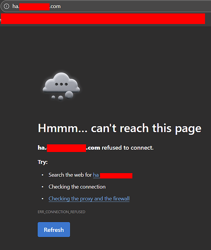

connection refused when i try to browse to my custom domain ha.mydomain.com:

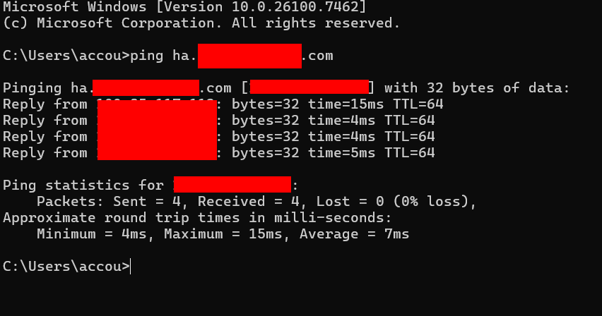

Does a “ping ha.mydomain.com” point to your NPM?

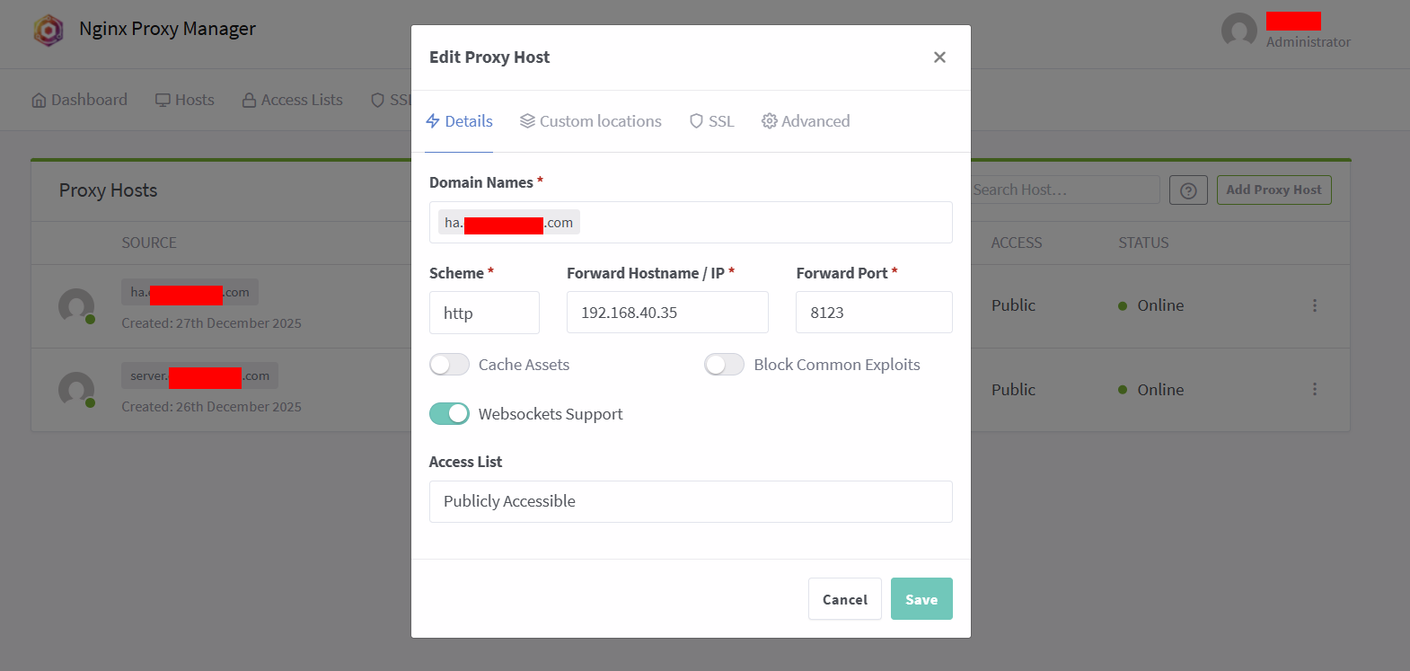

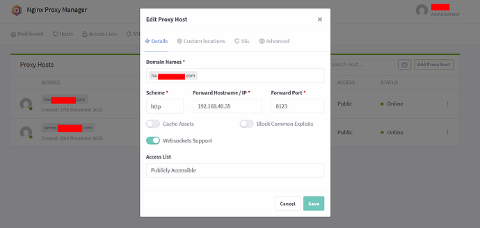

Please screenshot your NPM configuration for ha.

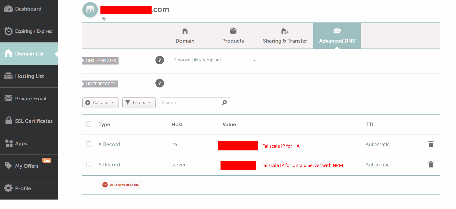

www.isitdownrightnow.com reports it as down. But my A Record for ha.mydomain.com points currently to the tailscale IP of my home assistant instance. this should maybe be the tailscale IP of my server instead?

Pinging:
DNS config:
NPM config:
Ping worked, so not a network connectivity issue, but a configuration issue.
In your DNS, it should be the tailscale IP of NPM, not the one of HA, i.e. the same as the one of unraid.
NPM will redirect based upon the hostname used.
And you don’t actually need the tailscale addon on HA in this configuration.
thanks for the help so far, i’m alsmost there i think (or hope)!

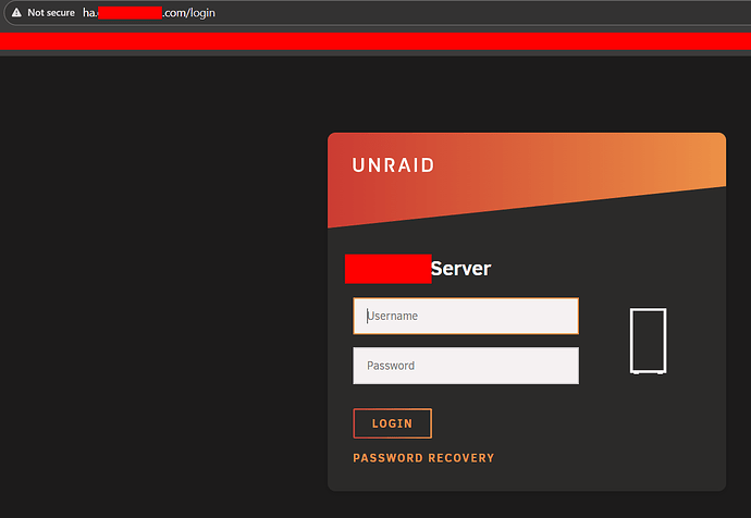

By putting the Tailscale IP of the server in the DNS A Record for ha.mydomain.com, i am now landing on the Unraid login page of my server instead of Home Assistant. (Just like when I am surfing to server.mydomain.com)
In NPM, the destination is set to http, the IP address of my home assistant yellow, and port 8123, so the question now is, why am I not directed there?
