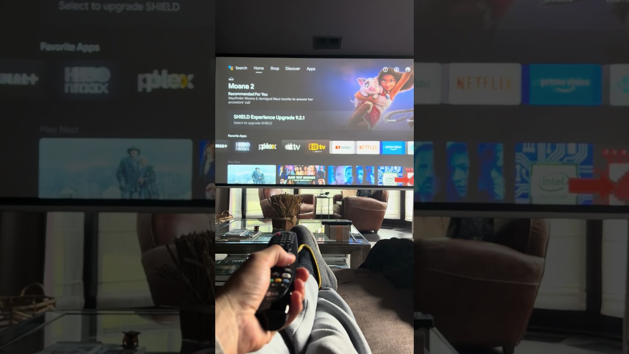

Here’s a quick video of what I achieved:
