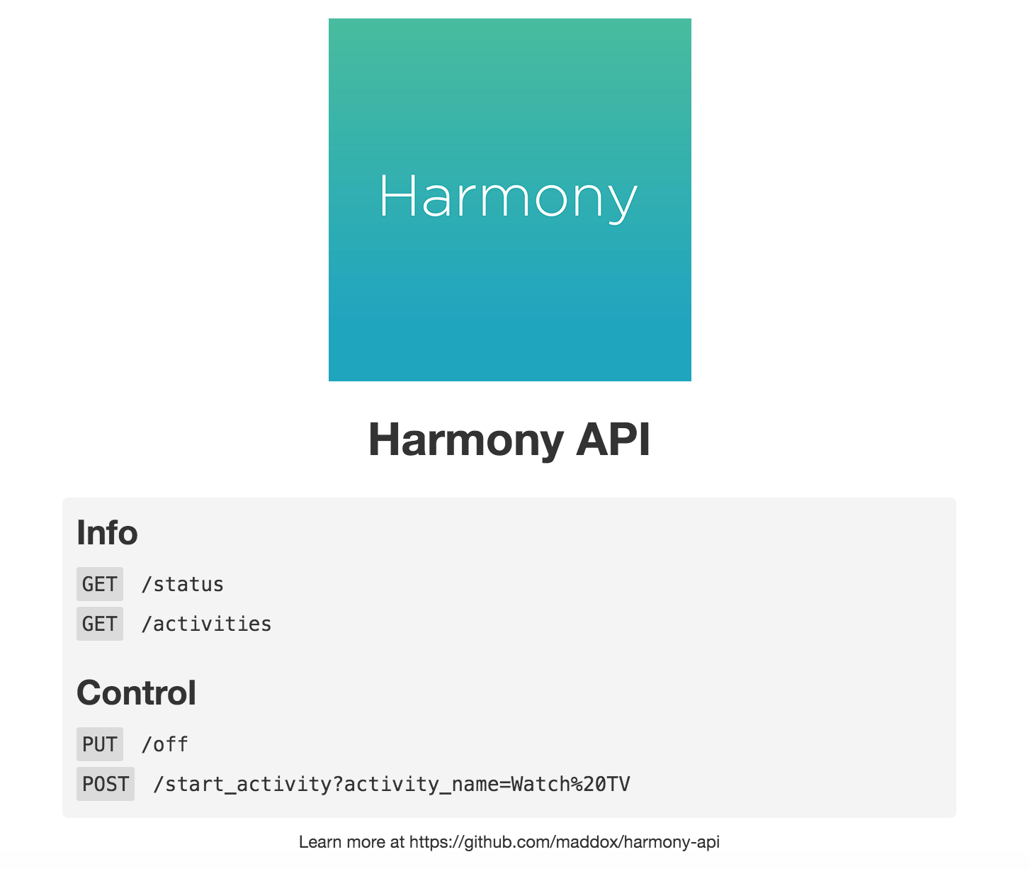

To the configuration.yaml file and it appeared to install properly. I did try installing Mosquitto and running that, but it said that the port was already in use (by Home Assistant, I assume). I then added the IP address of the Pi to the Harmony API config.json file, but all I see at http://raspberrypi.local:8282 is this:
Which I think is displaying information for HTTP, not the MQTT slugs like you mentioned.

What you see is correct. It’s just a simple front page to show that it’s working allowing you to click into some of the GET http endpoints to see the results of the API. The MQTT topics are not documented here, they are documented on the project’s README file on GitHub.
