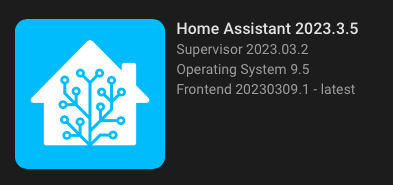

The versions match:
Screen Shot 2023-03-24 at 9.55.49 AM
Screen Shot 2023-03-24 at 9.56.43 AM
