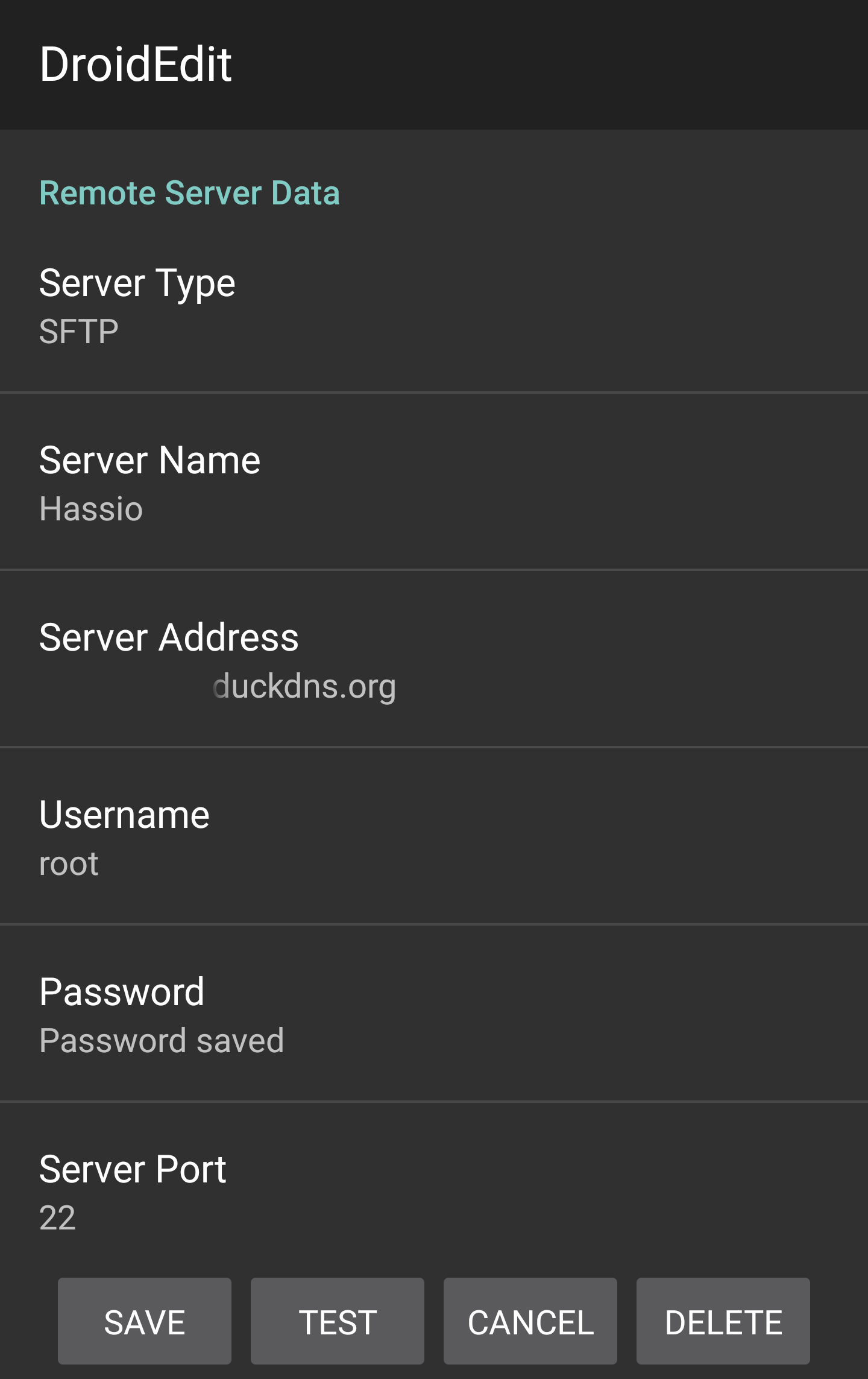

I use this one on my android phone:
which is very convenient because it directly shows my files via ssl.
On my linux computer I just added a network folder and it’s like being at home.

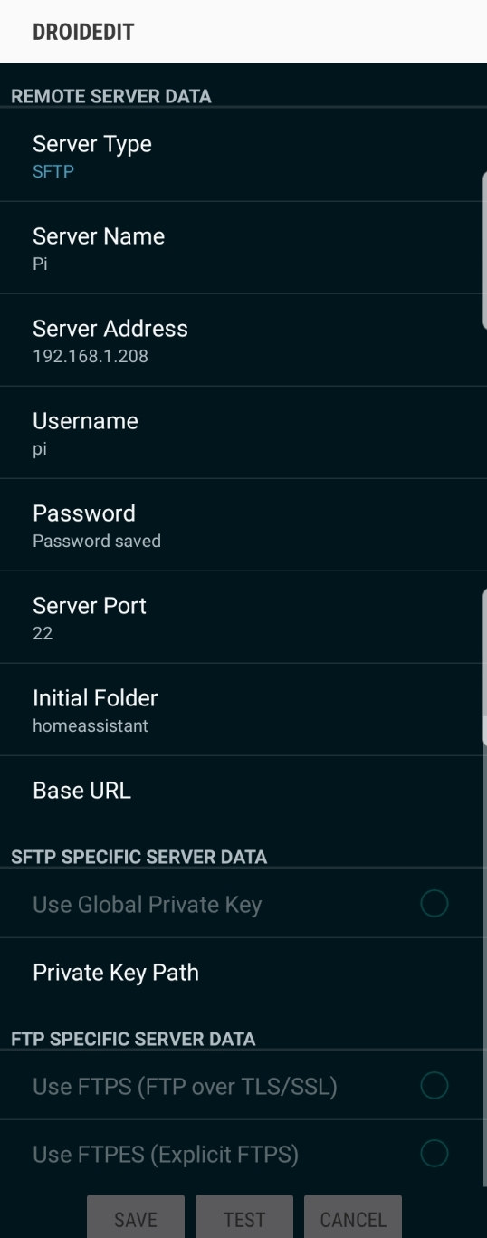

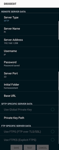

I can open files with DroidEdit but unable to save files. Do you add Private Key Path in DroidEdit settings ? If yes where can i find Private key Path.
No, I guess it’s because I use the duckdns url instead of the internal ip address.
