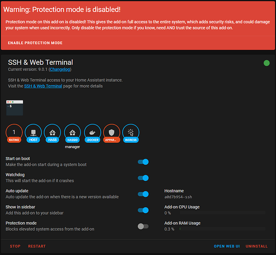

This is where disabling protection mode comes in.
  1. While SSH’ed into HA execute the following command:
docker exec -it homeassistant bash
What this will do is open an interactive bash shell on the actual homeassistant container where HA runs. From this shell any commands we run will be run in exactly the same way HA will run them from a shell command or command line sensor. This way we know if they work from there then they will work from HA. So now we can run our command like so and confirm that it works:
