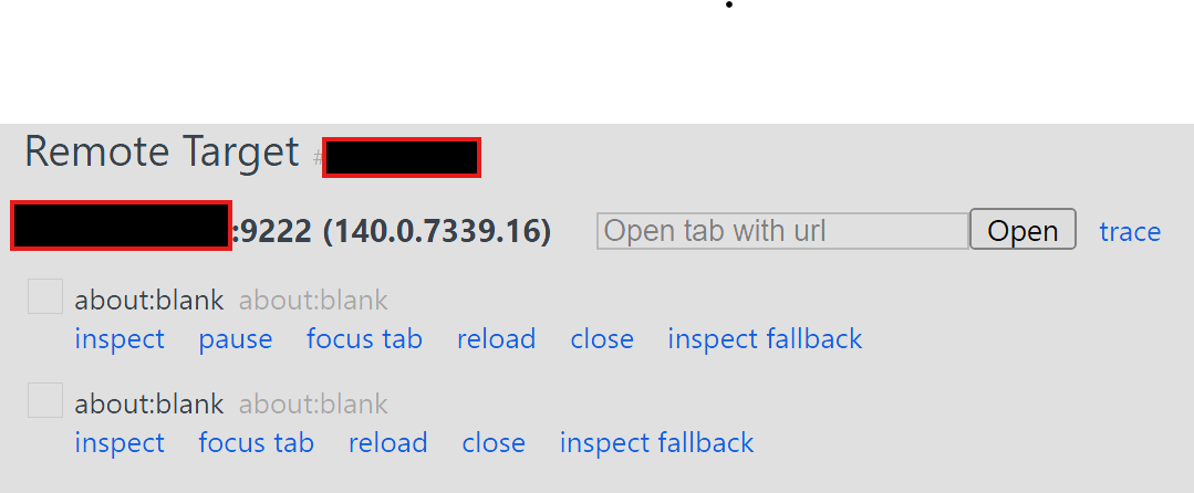

I am a complete noob and I am trying to learn/get this working.
I got the webview server running in HAOS as addon, but when I try to access the ip:9222 via chrome://inspect/devices I just get a blank page (about:blank) - I think I should see HA log in page instead, no?
expose_debug_proxy is enabled in HA
Is there something I am missing?
Thank you.
Okay, it looks like the server is running, but no devices are connected (no tab is open).
Do you have any device (screen) configured to use the server?
