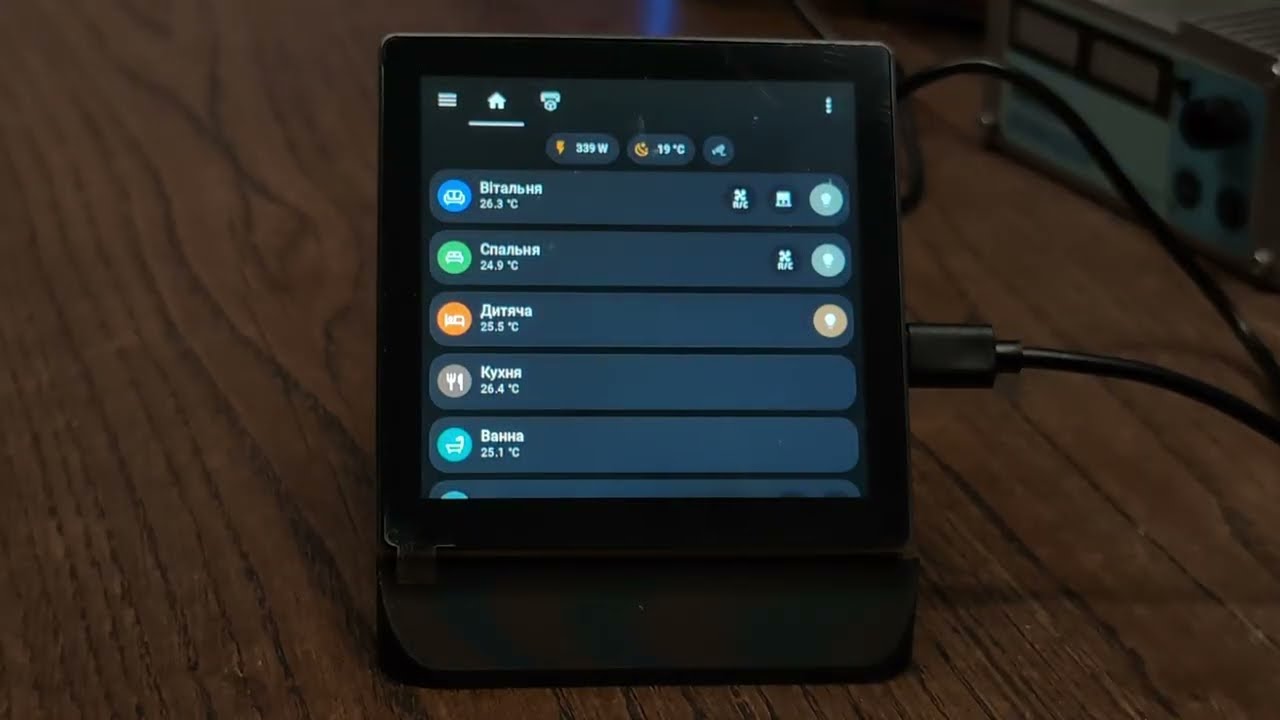

I previously built an “HA Deck” to simplify building HA dashboards on-device with LVGL. It worked, but I’ve always wanted to try an “RDP-style” path — render in a real browser, stream the result to an ESP32 display.
Remote WebView Server/Client renders your HA dashboard in headless Chromium and streams only the changed parts as JPEG tiles over WebSocket to an ESP32-S3 480×480 RGB screen. The device decodes and blits those tiles directly to the panel, with touch events sent back for scrolling and interaction.
The primary reason to try this approach is a real browser experience (fonts, CSS, charts, components) without re-implementing UI in LVGL.
Check demo:
How it works
  • Server opens your HA dashboard in headless Chromium
  • On each screencast frame, it computes diffs, merges adjacent tiles, JPEG-encodes them, and pushes over WS
  • ESP32-S3 decodes JPEG straight into the display buffer
  • Touch from the device is forwarded back to the page

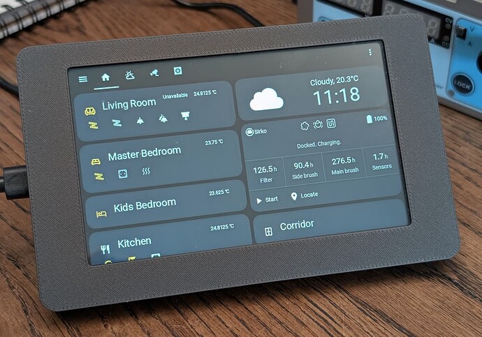

The updated server and the ESPHome external component have been released. The server repo also includes the Home Assistant add-on files, but I have no way to test whether it works (I’d be surprised if it worked on the first try — if anyone is willing to test and troubleshoot, let me know).
The main updates are:
  • ESPHome component: Any display supported by ESPHome (and with the new mipi_rgb platform, that’s a lot) can run Remote WebView.
  • Per-client settings: Each connection can supply its own width, height, tileSize, jpegQuality, maxBytesPerMessage, etc.
  • Client-driven navigation: The client can control which page to open.
  • Many quality-of-life improvements.
The built-in self-test shows ~7 ms (~143 FPS) for partial updates and ~58 ms (~17 FPS) for full updates. Note that this does not include data transmission/receipt time.

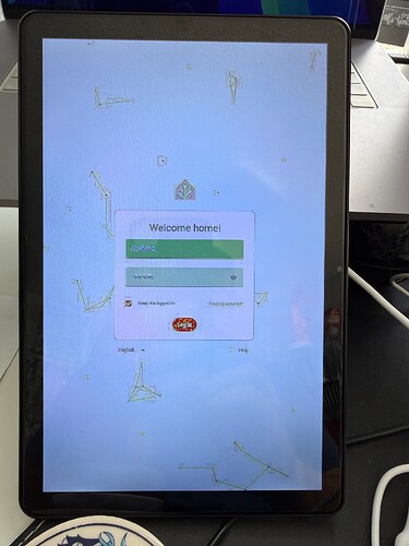

I also can see the homeassistant login screen but the quality is not good for this tablet.

Set url: "self-test" in the YAML, and it’ll run the FPS test.
On it, will update shortly. Tweaking some of the display parameters, since it is another display.
Ok did the self-test setting, this is what I got (partially):
[15:48:18.736][C][Remove_WebView:056]:   max_bytes_per_msg: 61440
[15:48:18.745][D][Remove_WebView:279][rwv_decode]: frame 12287: tiles 1 (996 bytes) - 1 ms
[15:48:18.909][D][Remove_WebView:279][rwv_decode]: frame 12288: tiles 2 (1391 bytes) - 1 ms
[15:48:18.933][D][Remove_WebView:279][rwv_decode]: frame 12289: tiles 1 (514 bytes) - 1 ms
[15:48:19.067][D][Remove_WebView:279][rwv_decode]: frame 12290: tiles 1 (667 bytes) - 2 ms
[15:48:19.326][D][Remove_WebView:279][rwv_decode]: frame 12291: tiles 1 (723 bytes) - 3 ms
[15:48:19.328][D][Remove_WebView:279][rwv_decode]: frame 12292: tiles 1 (467 bytes) - 1 ms
[15:48:19.382][D][Remove_WebView:279][rwv_decode]: frame 12293: tiles 2 (1102 bytes) - 1 ms
[15:48:19.833][D][Remove_WebView:279][rwv_decode]: frame 12294: tiles 1 (1012 bytes) - 0 ms
[15:48:20.770][D][Remove_WebView:279][rwv_decode]: frame 12295: tiles 1 (1001 bytes) - 0 ms
[15:48:21.778][D][Remove_WebView:279][rwv_decode]: frame 12296: tiles 1 (992 bytes) - 0 ms
[15:48:21.978][D][Remove_WebView:279][rwv_decode]: frame 12297: tiles 1 (2047 bytes) - 4 ms
[15:48:21.994][D][Remove_WebView:279][rwv_decode]: frame 12298: tiles 4 (4061 bytes) - 6 ms
[15:48:22.200][D][Remove_WebView:279][rwv_decode]: frame 12299: tiles 4 (4328 bytes) - 6 ms
[15:48:22.250][D][Remove_WebView:279][rwv_decode]: frame 12300: tiles 4 (4428 bytes) - 6 ms
[15:48:22.301][D][Remove_WebView:279][rwv_decode]: frame 12301: tiles 4 (4445 bytes) - 6 ms
[15:48:22.506][D][Remove_WebView:279][rwv_decode]: frame 12302: tiles 1 (2401 bytes) - 4 ms
[15:48:22.903][D][Remove_WebView:279][rwv_decode]: frame 12303: tiles 2 (2108 bytes) - 2 ms
[15:48:23.833][D][Remove_WebView:279][rwv_decode]: frame 12304: tiles 2 (2128 bytes) - 2 ms
[15:48:24.752][D][Remove_WebView:279][rwv_decode]: frame 12305: tiles 2 (2131 bytes) - 2 ms
[15:48:25.887][D][Remove_WebView:279][rwv_decode]: frame 12306: tiles 2 (2118 bytes) - 2 ms
[15:48:26.793][D][Remove_WebView:279][rwv_decode]: frame 12307: tiles 2 (2124 bytes) - 2 ms
[15:48:27.831][D][Remove_WebView:279][rwv_decode]: frame 12308: tiles 2 (2131 bytes) - 2 ms
[15:48:28.853][D][esp-idf:000][sdio_read]: E (51108) sdmmc_io: sdmmc_io_rw_extended: sdmmc_send_cmd returned 0x109
[15:48:28.855][D][esp-idf:000][sdio_read]: E (51108) H_SDIO_DRV: sdio_read_task: Failed to read data - 265 4518 4518
[15:48:29.506][D][Remove_WebView:279][rwv_decode]: frame 12309: tiles 1 (25982 bytes) - 190 ms
[15:48:29.874][D][Remove_WebView:279][rwv_decode]: frame 12310: tiles 1 (654 bytes) - 0 ms
[15:48:29.927][D][Remove_WebView:279][rwv_decode]: frame 12311: tiles 1 (2544 bytes) - 4 ms
[15:48:30.115][D][Remove_WebView:279][rwv_decode]: frame 12312: tiles 1 (2787 bytes) - 4 ms
[15:48:30.147][D][Remove_WebView:279][rwv_decode]: frame 12313: tiles 1 (2829 bytes) - 4 ms
[15:48:30.319][D][Remove_WebView:279][rwv_decode]: frame 12314: tiles 1 (2847 bytes) - 4 ms
[15:48:30.372][D][Remove_WebView:279][rwv_decode]: frame 12315: tiles 1 (2848 bytes) - 4 ms
[15:48:30.797][D][Remove_WebView:279][rwv_decode]: frame 12316: tiles 1 (1291 bytes) - 1 ms
[15:48:31.918][D][Remove_WebView:279][rwv_decode]: frame 12317: tiles 1 (1293 bytes) - 1 ms
[15:48:31.957][D][Remove_WebView:279][rwv_decode]: frame 12318: tiles 1 (2232 bytes) - 3 ms
[15:48:32.179][D][Remove_WebView:279][rwv_decode]: frame 12319: tiles 1 (707 bytes) - 4 ms
[15:48:32.179][D][Remove_WebView:279][rwv_decode]: frame 12320: tiles 1 (556 bytes) - 2 ms
[15:48:32.330][D][Remove_WebView:279][rwv_decode]: frame 12321: tiles 1 (397 bytes) - 0 ms
[15:48:32.894][D][Remove_WebView:279][rwv_decode]: frame 12322: tiles 2 (2148 bytes) - 2 ms
[15:48:33.790][D][Remove_WebView:279][rwv_decode]: frame 12323: tiles 2 (2149 bytes) - 2 ms
[15:48:34.816][D][Remove_WebView:279][rwv_decode]: frame 12324: tiles 2 (2151 bytes) - 2 ms
[15:48:35.945][D][Remove_WebView:279][rwv_decode]: frame 12325: tiles 2 (2152 bytes) - 2 ms
[15:48:36.904][D][Remove_WebView:279][rwv_decode]: frame 12326: tiles 2 (2146 bytes) - 2 ms
[15:48:37.861][D][Remove_WebView:279][rwv_decode]: frame 12327: tiles 2 (2151 bytes) - 2 ms
[15:48:37.896][D][Remove_WebView:279][rwv_decode]: frame 12328: tiles 3 (4721 bytes) - 6 ms
[15:48:38.066][D][Remove_WebView:279][rwv_decode]: frame 12329: tiles 1 (2488 bytes) - 4 ms
[15:48:38.093][D][Remove_WebView:279][rwv_decode]: frame 12330: tiles 1 (2386 bytes) - 4 ms
[15:48:38.403][D][Remove_WebView:279][rwv_decode]: frame 12331: tiles 1 (2184 bytes) - 4 ms
[15:48:38.403][D][Remove_WebView:279][rwv_decode]: frame 12332: tiles 1 (2150 bytes) - 4 ms
[15:48:38.785][D][Remove_WebView:279][rwv_decode]: frame 12333: tiles 1 (651 bytes) - 0 ms
[15:48:39.806][D][Remove_WebView:279][rwv_decode]: frame 12334: tiles 1 (646 bytes) - 0 ms
[15:48:40.859][D][Remove_WebView:279][rwv_decode]: frame 12335: tiles 1 (952 bytes) - 0 ms
[15:48:41.746][D][Remove_WebView:279][rwv_decode]: frame 12336: tiles 1 (646 bytes) - 0 ms
[15:48:42.770][D][Remove_WebView:279][rwv_decode]: frame 12337: tiles 1 (941 bytes) - 0 ms
[15:48:43.805][D][Remove_WebView:279][rwv_decode]: frame 12338: tiles 1 (655 bytes) - 0 ms
[15:48:44.183][I][safe_mode:042]: Boot seems successful; resetting boot loop counter
[15:48:44.188][D][esp32.preferences:143]: Writing 1 items: 0 cached, 1 written, 0 failed
The graphics still look awful kind of like the previous picture.
This is my full esphome yaml so far:
esphome:
  friendly_name: esp32p4tablet
esp32:
  board: esp32-p4-evboard
  cpu_frequency: 400MHz
  flash_size: 16MB
  framework:
    type: esp-idf
    sdkconfig_options:
      COMPILER_OPTIMIZATION_SIZE: y
      CONFIG_SPIRAM_FETCH_INSTRUCTIONS: y
      CONFIG_SPIRAM_RODATA: y
    advanced:
      enable_idf_experimental_features: yes
    components:
      - name: "espressif/esp_websocket_client"
        ref: 1.5.0
      - name: "espressif/esp-dsp"
        ref: 1.7.0
      #- name: "bitbank2/jpegdec"
      #  ref: 1.6.2
      #  source: https://github.com/bitbank2/JPEGDEC
        source: https://github.com/strange-v/jpegdec-esphome
api:
  encryption:
    key: <secret>
ota:
  - platform: esphome
    password: <secret>
wifi:
  networks:
    - ssid: <secret>
      password: <secret>
  ap:
    ssid: "Esp32P4Tablet Fallback Hotspot"
    password: <secret>
captive_portal:
logger:
  hardware_uart: USB_SERIAL_JTAG
  level: DEBUG
  logs:
    lvgl: INFO
    display: INFO
    app: DEBUG
external_components:
  - source: github://willumpie82/esphome@dev
    components: [mipi_dsi]
  - source: github://kvj/esphome@jd9365_gsl3680
    refresh: 0s
    components: [gsl3680]
  - source: github://esphome/[email protected]
    components: [i2c]
  - source: github://strange-v/RemoteWebViewClient@main
    refresh: 0s
    components: [ remote_webview ]
  #- source:
  #    type: git
  #    url: https://github.com/supremelucifer/RemoteWebViewClient
  #    ref: main
  #  components: [ remote_webview ]
esp_ldo:
  - channel: 3
    voltage: 2.5V
esp32_hosted:
  variant: ESP32C6
  reset_pin: 54
  cmd_pin: 19
  clk_pin: 18
  d0_pin: 14
  d1_pin: 15
  d2_pin: 16
  d3_pin: 17
  active_high: true
psram:
  speed: 200MHz
switch:
  - id: backlight_
    platform: gpio
    pin: GPIO23
    restore_mode: ALWAYS_ON
color:
  - id: my_red
    red: 100%
    green: 0%
    blue: 0%
# LVGL Display
display:
  - platform: mipi_dsi
    model: JC8012P4A1
    reset_pin: GPIO27
    show_test_card: False
    update_interval: never
    auto_clear_enabled: False
    color_order: RGB
    invert_colors: False
    dimensions:
      width: 800
      height: 1280
i2c:
  - id: i2c_bus
    sda: GPIO7
    scl: GPIO8
    #scan: true
    frequency: 400kHz
#lvgl:
#  buffer_size: 100%
#  byte_order: little_endian
#  touchscreens:
#    - touchscreen_id: touchscreen_
touchscreen:
  - platform: gsl3680
    reset_pin: GPIO22
    interrupt_pin: GPIO21
    transform:
      swap_xy: false
      mirror_x: false
      mirror_y: false
    i2c_id: i2c_bus
remote_webview:
  display_id: my_display
  device_id: esp32p4tablet
  server: 192.168.0.208:8081
  #url: http://192.168.0.43:8123/dashboard-home/home
  url: "self-test"
  full_frame_tile_count: 1
  jpeg_quality: 85
text:
  - platform: template
    optimistic: true
    restore_value: false
    mode: TEXT
    min_length: 1
    set_action:
      - lambda: |-
          if (!id(rwv).open_url(std::string(x.c_str()))) {
            id(rwv).set_url(std::string(x.c_str()));
            ESP_LOGI("remote_webview", "URL queued (not connected): %s", x.c_str());
UPD: added esphome config
Final result shown in the tablet:
FPS
Partial: 200 (5ms)
Full: 5 (190ms)
