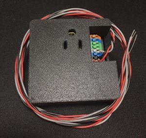

I’ve bought 2 of these, Mike is super responsive and the hardware is a step above (integrated 120v plug/receptacle) and it’s much less expensive than other ratgdo options. There’s also a version with USB-C also, which makes it easier to flash over a cable, though both are set up for easy OTA flashing out of the box.
Just another option if support (or hardware features or price) from other vendors is disappointing.
